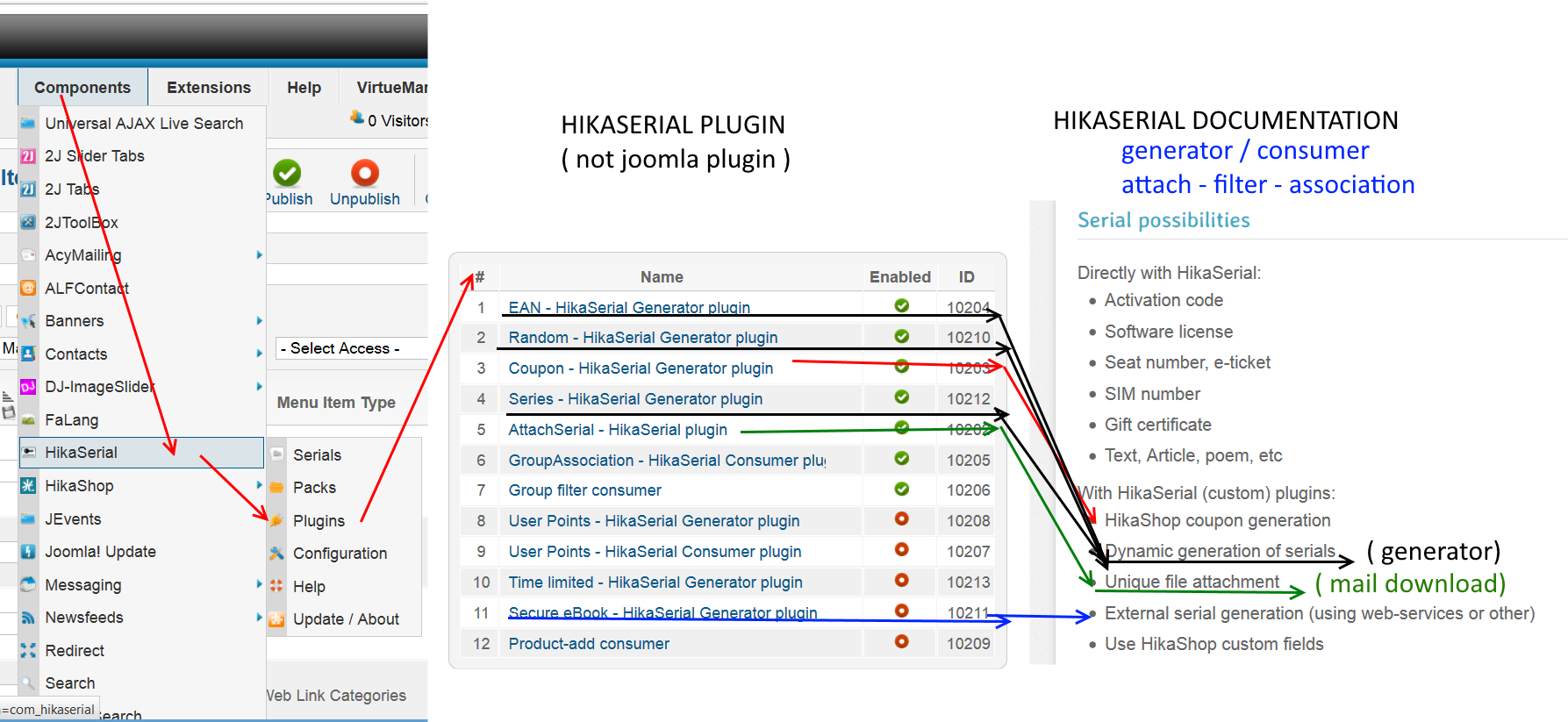

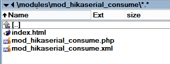

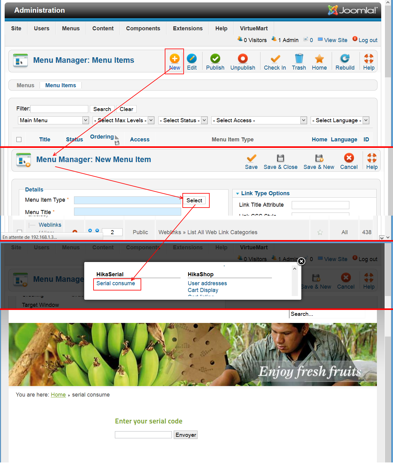

for information the consumption system need to create a link to a hikashop module name "serial consume" . In the FrontEnd when click on this link you ll see an input field to enter a value(capture screen from beez5 template ) . This value is store in rdbm in the colum of name serial_data .
For the module "serial consume" there seem there is no specific parameters . the link is index.php?option=com_hikaserial&view=serial&layout=consume.
the plug in hikaserial are not plug in you have to enable disable they contain item you have create and configure like module !! ?? . Many hikaserial plugin you ll configure ll be use during process of buying
idon't know what occur in rdbms when the value is enter .
it is the way i understand hikaserial GUI BE for consume.
the other side is of hikaserial is to be basic create a raster with the "value" on it . the value could be render using symbology as QRCode or EAN ... that should be print and give to someone else to be use ( enter code in webpage or scan ) ...
If you implement a software , the serial _data could be a key to be able to use the software that ll be send after payment . Hikaserial can also use for many anothers things see Hikaserial plugins !!
