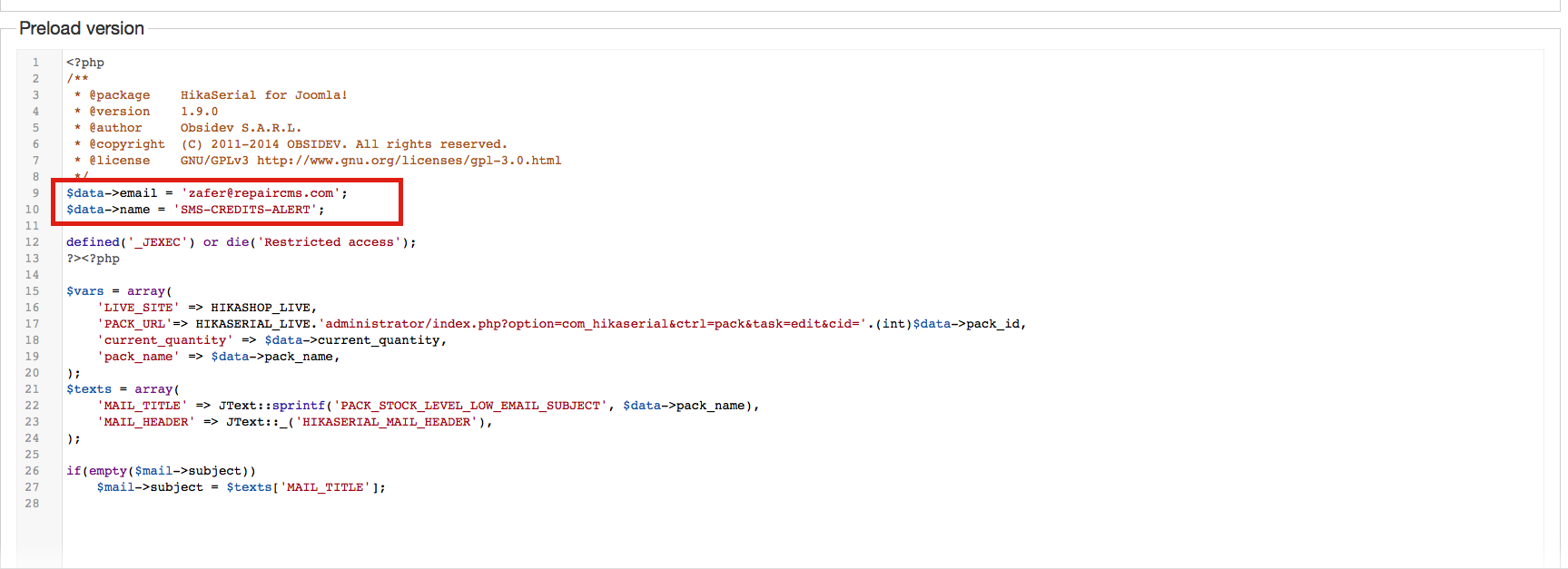

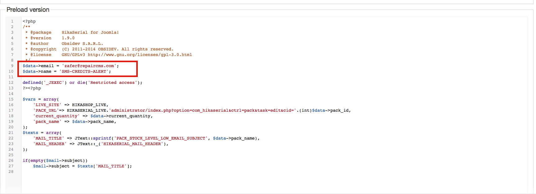

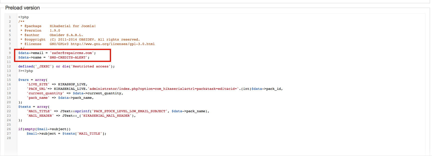

  • Posts: 29
11 years 7 months ago #184501
Hi!
I did the settings in the configuration E-mail backend and set the quantity in serial pack to modify when quality was reached, but i did not get any notification.
Then I add the 2 lines and override the E-Mail template
$data->email = 'This email address is being protected from spambots. You need JavaScript enabled to view it.';
$data->name = 'My email'
nothing change! Not notification goes out. Can you help please?
regards,
Zafer

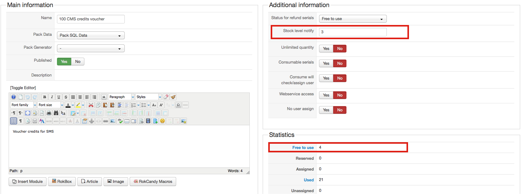

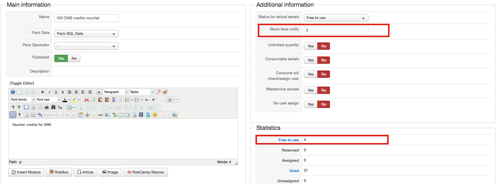

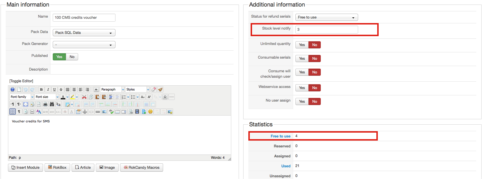

  • Posts: 29
11 years 7 months ago #184644
Hi Jerome,
all setting are correct set. Look at the screenshot. Do I need any config in the main product config page?
regards
11 years 7 months ago #184645
Once again ; the email is sent by HikaSerial when a serial is being assigned (someone bought a product with a serial) and the pack quantity is lower or equal to the stock level number.
You currently have 4 available serials and the stock level is set to 3.
4 is higher than 3 so HikaSerial won't send any email unless this quantity is lower or equal to 3.
And when the pack quantity will be lower or equel to 3 ; each time a serial will be assign (by an order confirmation which ask for "free" serials in that specific pack), you will receive a notification email.

11 years 7 months ago #184673
Okay, I believe you.
Well in HikaSerial 1.9.0, the emails are also displayed in the HikaShop email listing.
So the best we will force the email loading even if the HikaShop configuration does not contain the mail reference.
Please edit the file "administrator/components/com_hikaserial/classes/pack.php" and replace
$mail = $mailClass->get('pack_quantity_low', $pack);
By
$mail = $mailClass->load('pack_quantity_low', $pack);
I'll update the HikaSerial package too.
