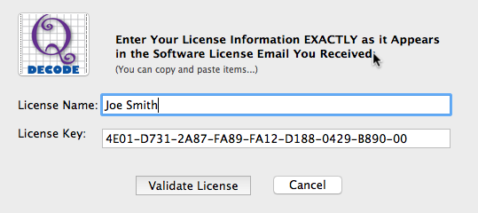

I have a software package that I wrote that is downloadable from a website.
I was using a VirtueMart hack to create an md5 Hash that was turned into a Serial # which could then be entered into the program to licence it.
The output looks something like this:
Joe Smith
4E01-D731-2A87-FA89-FA12-D188-0429-B890-00
I have attached a screenshot of the licensing screen that is in the software package so you get the idea.

A version of this is also inside the software package in order to validate the hash.
