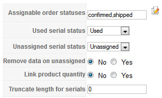

I've managed to get it to assign a random serial from the 'pack' so far, but the serial only shows up after I go into the order and hit "Refresh Associations". I have "Assignable Order Statuses" set to confirmed, shipped in the HikaSerial configuration.
Am I missing something in the HikaShop configuration so that the serial generation code gets called when the payment is confirmed? or could this be related to me still using the PayPal sandbox environment?

When an HikaShop order is updated (when the PayPal notification validate the order for example), HikaSerial is called.
But when a plugin update an order, it does not update every fields of the order so HikaSerial load the full order information and store them into " $order->cart ".
So you should access to the information by this variables.
$order->cart->order_user_id
$order->cart->products
I will investigate more about your assignation problem.
An access to your backend might be required (or I can send you a preview version of HikaSerial with some modifications).
The following user(s) said Thank You: cwm33
