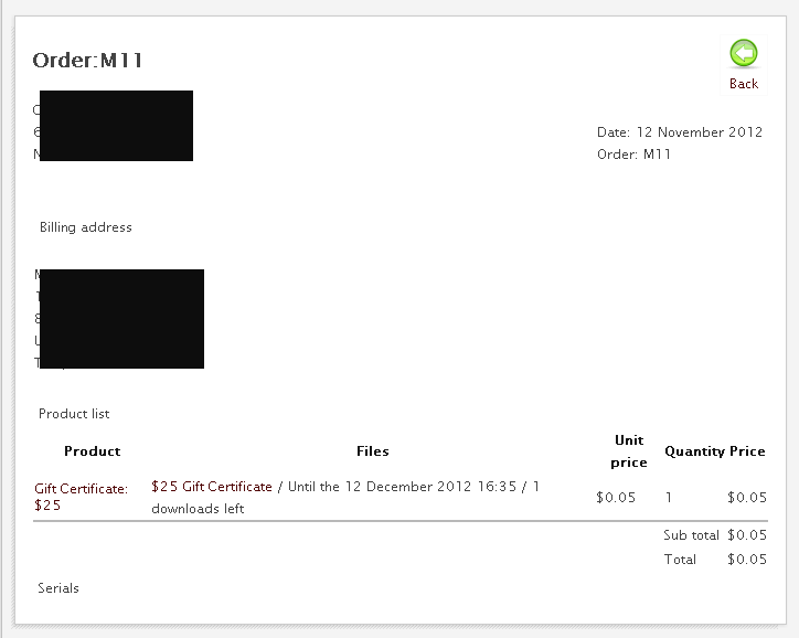

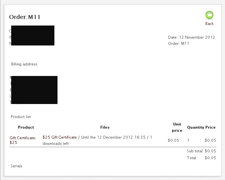

Now I did get the confirmation email link and when I click it, it says "INVALID_FILE_NUMBER" .
There is no indication of a serial number in the email. When I view the order in my browser I can only see underneath in text the word "serials"

13 years 9 months ago #75974
There was a bug in HikaShop 2.0 with file download.
Please re-download HikaShop 2.0 to fix this problem.
In order to change the configuration of "serial assignation"
www.hikashop.com/en/hikashop/111-hikaser...nable_order_statuses
In the HikaShop back-end, open your order.
You should see a "Serials" zone with a "Refresh associations" button at the right.
If the serial table is empty, click on the "refresh" button to reprocess serial associations (it could happen if the hikaserial configuration changed after the order last modification).
I have modified the default view for "show_order_front_show" in order to do not display the title "Serials" when there is no serial attached to the order.
This modification would be include in the next package (1.5.1)
