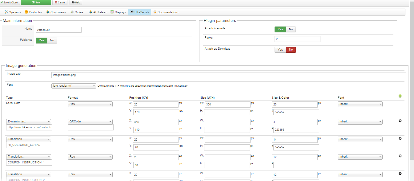

13 years 4 months ago - 13 years 4 months ago #110000 by joe.vrolijk
Hi Jerome,
I also have difficulties, with the attach. My order doesnt attach a the nice looking ticket.
I want to start a raffle and i followed the entire tutorial, and double checked every setting, everything works and i do get a serial. Only as plain text in the email.
Tried everything! Still no luck and no attachment (It does give a serial in the text, but i really like the ticket look. Do you have any tips? (see my attachment for the settings)
I'm willing to give you access to my joomla.
Thanks so much!
Last edit: 13 years 4 months ago by Jerome.

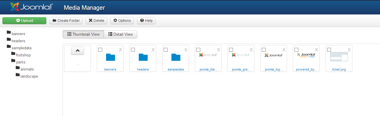

13 years 4 months ago #110034 by joe.vrolijk
Hi Jerome,
My apologies, for the hurry. Won't do that anymore, and i appriciate all your help!
Thanks for you reply, i think my ticket.png file is uploaded correctly though (see attachment of the media manager).
Dont know what to do :(

13 years 4 months ago #110073 by Jerome
I change the image file name to "/images/ticket.png".
I guess that, the plugin didn't find correctly the image with "images/ticket.png".. I will investigate on that and make a fix for the next release.
The following user(s) said Thank You: joe.vrolijk
13 years 4 months ago #110074 by joe.vrolijk
Thank you so much Jerome! It works!

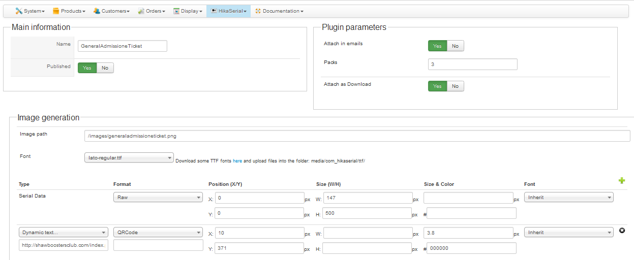

12 years 11 months ago #131033 by gtartjr
I'm also having a problem with the SerialAttach download. I get a download link in the email but the attached file is empty (0 bytes). I have confirmed that my template file is in the /images folder and my product file references the Plugin with #hikaserial:attachserial:2. The Plugin ID is 2. What else should I check?
12 years 11 months ago #131040 by Jerome
Please try to download the file in the HikaShop backend (when seeing the full order). If you have a blank image it can be a problem opening the file ; if it is a blank html page it can be a PHP error ; If you got a 404 page, it means that the file is not found.
If you are using a Linux server, please check the name case (better to have all in lowercase, without spaces or special characters).
12 years 11 months ago #131050 by gtartjr
I receive the same empty file when attempting to open it from the backend. I am able to open and view it successfully via FTP. I also renamed the file to the more Unix-friendly format, (all lower-case). My error log is clear. Same problem.
12 years 11 months ago #131131 by Jerome
Please provide a screenshot of your attach serial configuration.
12 years 11 months ago #131210 by gtartjr
Configuration is attached:
