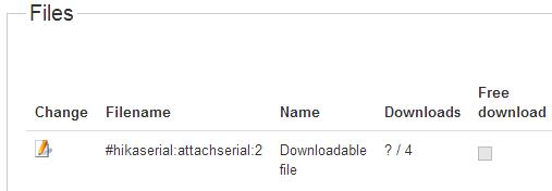

Image Generation for Attach Serial Did Not Attach
  • Posts: 6
12 years 10 months ago #131312
Any ideas?

The only thing strange I see is that the value "3.8" is not a valid value for a pixel number. Please use "3" or "4" but not float value.
But you didn't answer to my question about the blank page. I still don't know which type of blank page it is and what is the result if you try to download it from the backend.
  • Posts: 6
12 years 10 months ago #131383
I'm not getting a blank page, (no blank HTML, no 404 error). It's simply an attached file with no data, (an empty file, 0 bytes length). Any program that attempts to open it reports that it is empty. The template file, however is in the /images folder and can be viewed and opened successfully with FTP and any image viewer program.

I fixed your product configuration.
You hadn't set the "filename" but put it as the "name", which is not understandable for HikaSerial as you can imagine.
Now you have a "file not found" problem because the "attach serial" configuration is not configured right. The file can't be find and I can't know what are the files you want to use.
Please use the common way : "/images/my_image_name.png" (or jpg). And please check that the file is right in the folder and with the right file name. For the moment, your two configuration point to files which does not exist.

The file I want to download is the eticket, (with the QRCODE as defined), that is output from the AttachSerial plugin . I guess I'm really confused about how the output is generated, where it's stored, and how to reference it, (a process flow diagram in the documentation would be very helpful). I assumed by providing a template name in the 'input path' of the Attach Serial plugin and the dynamic text I wish to add, would produce an output file that could be referenced by #hikaserial:attachserial:2. This is obviously not correct so I need to understand the correct method.
