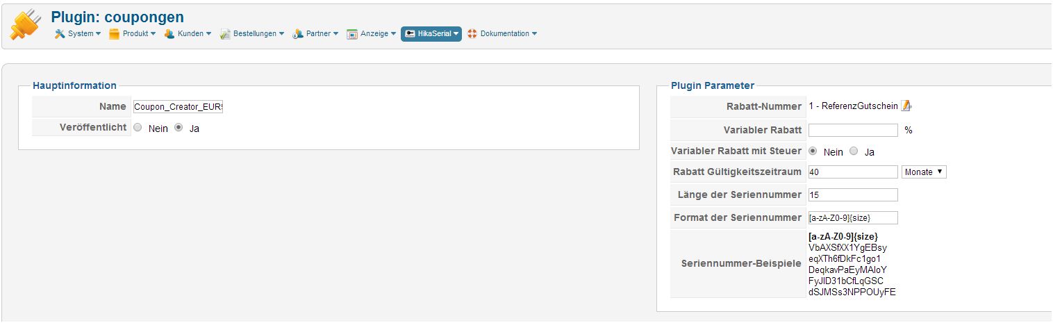

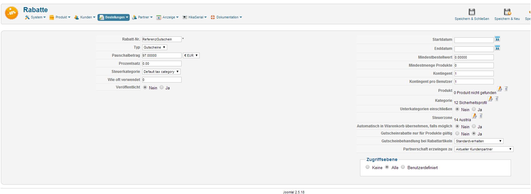

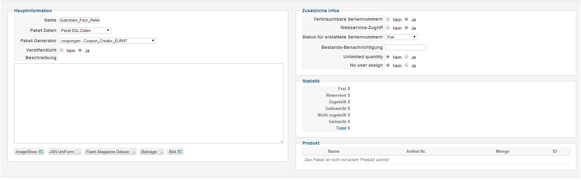

12 years 5 months ago #149130
is the tag {hikaserial_genpack:3} still correct? 3 = id of pack
ok, i have attached some screenshots
ps: the coupon itselfs will be generated correctly. if i run the process at the newsletter-queue. the newsletter will not be sent, but a new coupon-serial is created to the correct pack.
