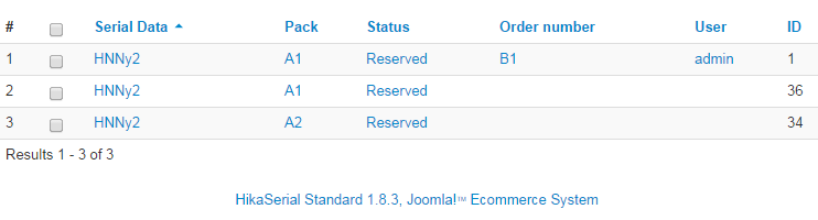

Please note: URL request gives the answer to the question: serial of specific pack is valid or not. XML answer with pack data needs to be analyzed. For example, if 2 serials in different packs have the same serial data, which serial will be shown in xml(see attachment)? If both, How I need to parse and check it? I think, it greatly complicates the development of custom consumer plugin...

But your screenshot is outside of the HikaSerial's prerogative: You have two identical serials in the same pack.
At this moment you can't use any web service or consuming.
The classical generator checks that the generate serials are unique ; so this kind of data is not possible unless you generate manually the data.
