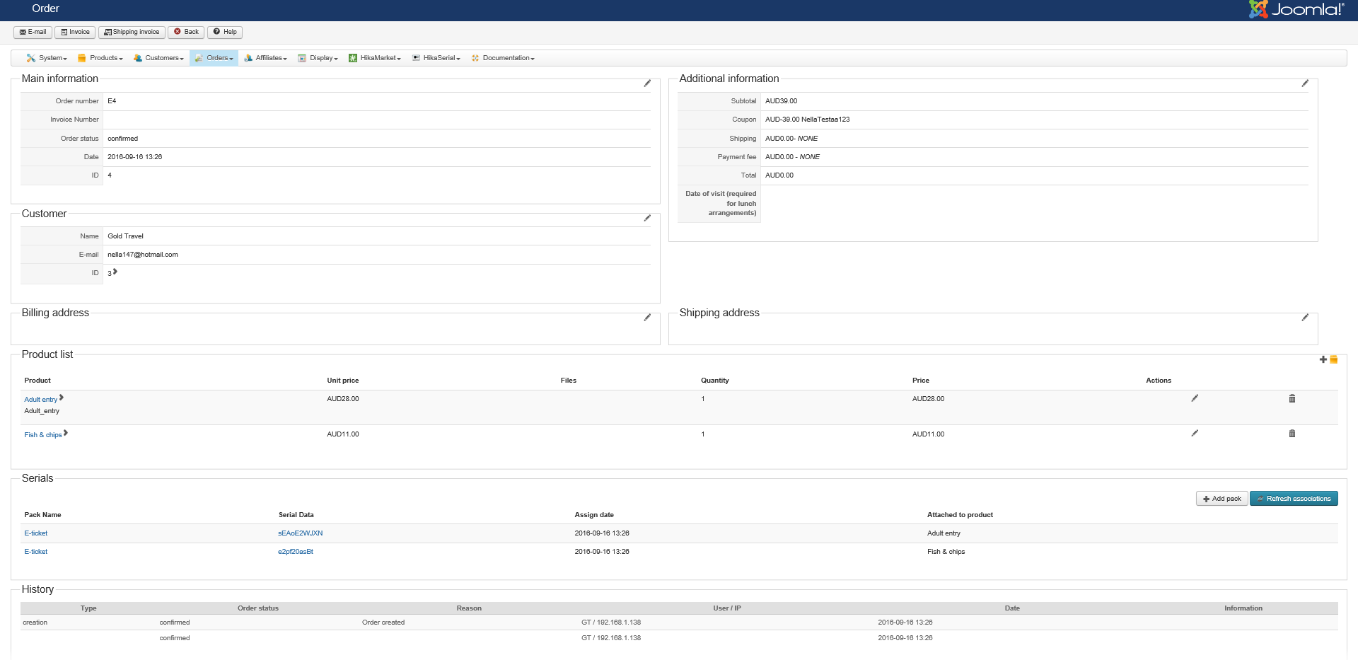

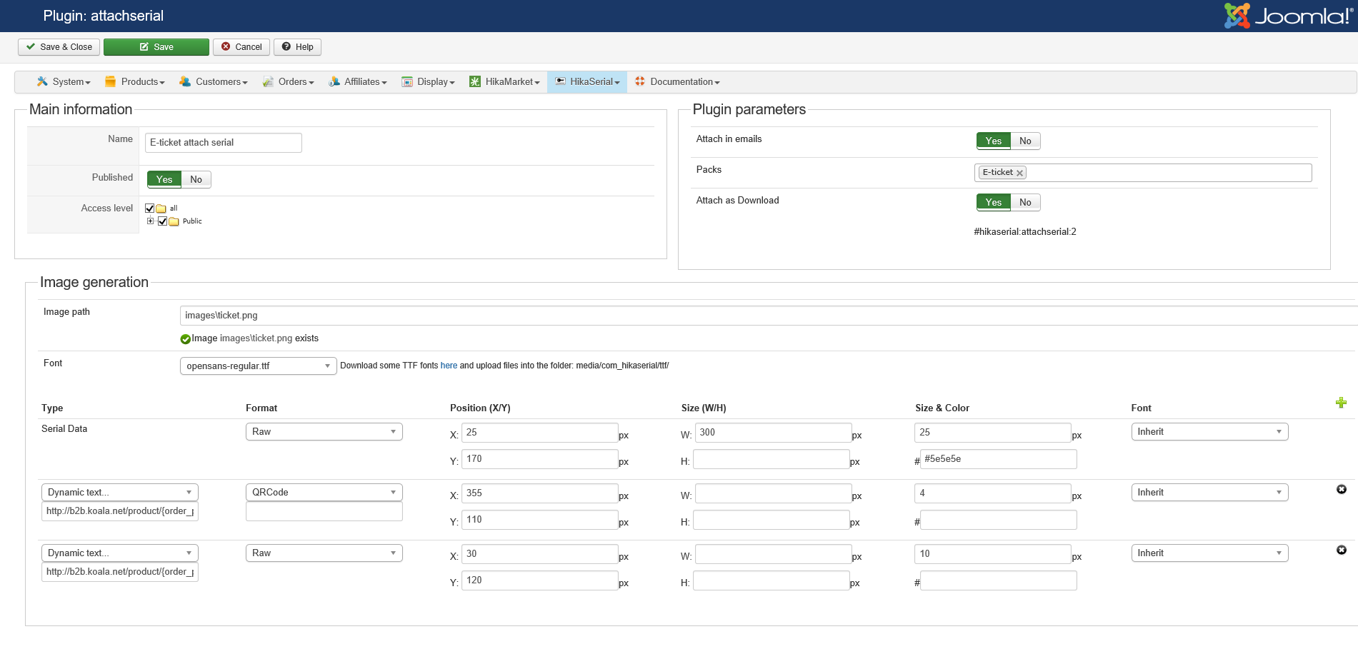

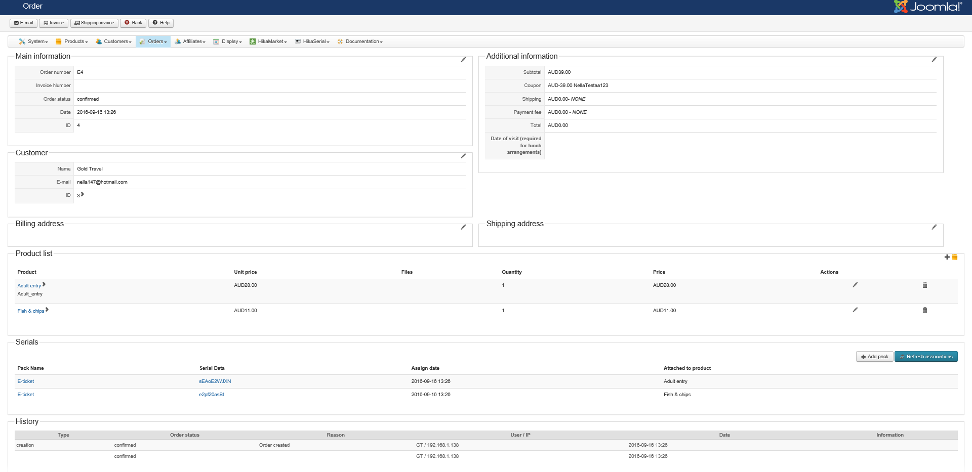

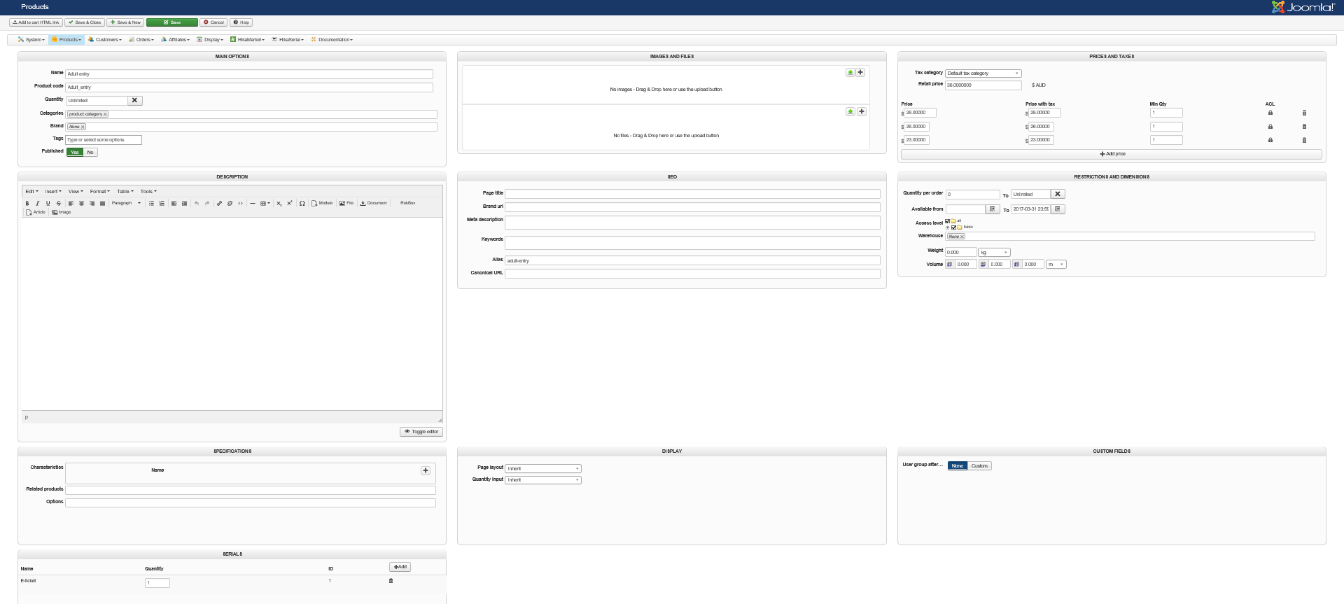

I do have a serial visible in the backend order details, and all orders are listed as confirmed. The serials are linked to the correct pack and I have set these to be attached as download.
I have also attached the e-ticket serials to each product, but I'm not sure if this is the same as "creating a virtual product file for your products with serial"?
Please see the attached screenshots for illustration.
9 years 11 months ago #250400
You're configuration and your order looks okay.
You should be able to use the "email" button in the order details to send manually an email.
In that email, the "attach image" plugin will also attach his content.
If in that email, you still do not have emails ; it would be interesting to look at how Joomla is sending emails and maybe, tweak some advanced settings in the Joomla side of the plugin.
In "Joomla > Extensions > Plugins", you will be able to see the "attach serial" plugin and access to the advanced settings.
The setting "attach a virtual file" will use another way to include an attachment to the email. We know that some configuration could have issue with the "virtual files".
The "add attachment with mime type" can also be a source of issue with some email servers. But in most cases, that "mime type" is needed by the email server.

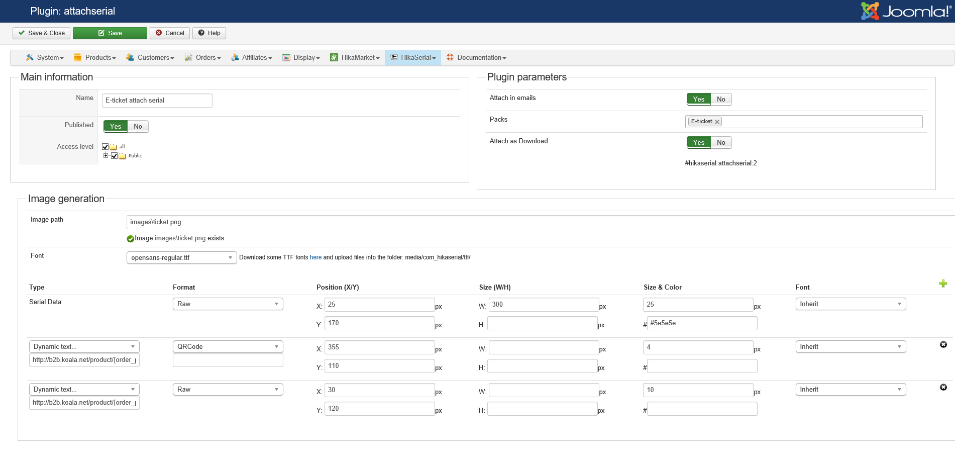

Hi again Jerome, I have played around with the e-ticket customisation using this tutorial
www.hikashop.com/support/documentation.h...ns-attachserial-form
Is there a way to have the purchased product name appear on the ticket? I tried using the dynamic text type and also translation, but haven't been able to figure out what the url or namekey should be.. Am I even on the right track?
Also, is there a way of having additional fields/information on the ticket? So for example if there is a required field on certain products and that product is purchased, the input for that field would appear on the ticket.
I sell admission and lunch tickets for a tourist attraction, and have set it so that when lunch tickets are purchased, customers must choose their visit date. It would be helpful to have this date on the tickets, along with the product name.
9 years 11 months ago #251072
in the list of the types you will find the "Product..." which allows you to display the elements from the "product" table.
By putting the value "product_name", you will display the data from the "product" field "product_name".
If you use a dynamic text, you have to use a tag, like
{product.product_name}
