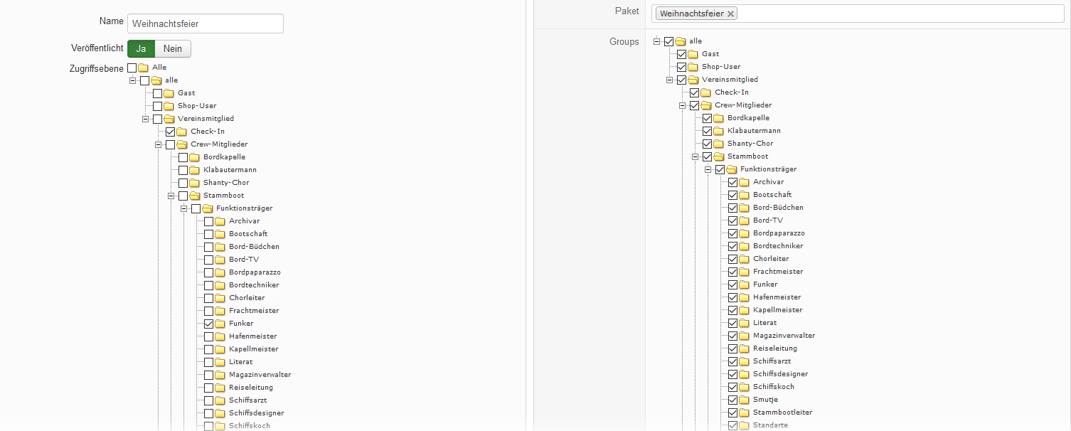

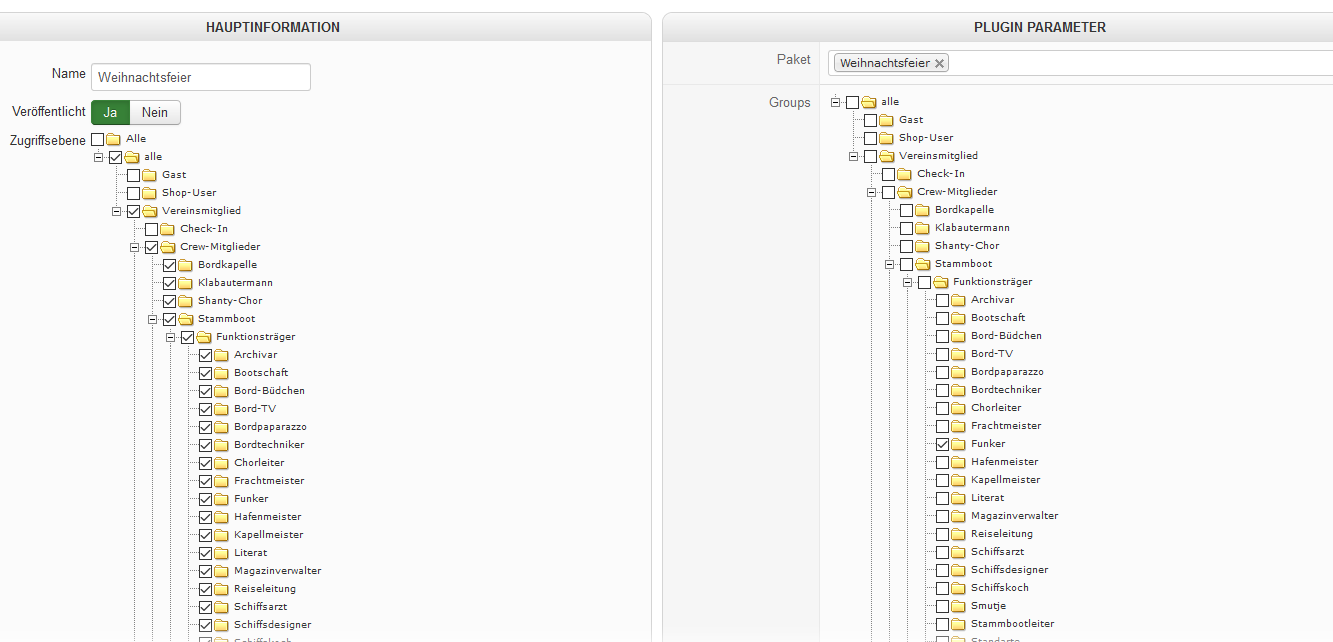

  • Posts: 19
8 years 10 months ago #282058
Hi Jerome!
Many thanks for your replay. I tried to solve the problem - but I really despair of getting it working :-)
As you told me I used the plugin "Group filter consumer" as you can see on the first picture. The picture "Zugriffsrechte" show the rights I gave. I want to enable two groups to consume the serials: Check-in and Funker (administrator).
But now I cannot consume anymore :-)) although I am an admin.
I was logged-in on the website and on the backend, too. But no chance to consume for me :-)
And I am REALLY helpless :-//
I enclosed the general configuration and the pack configuration, too.
I am really looking forward to reading from you
regards,
Frank

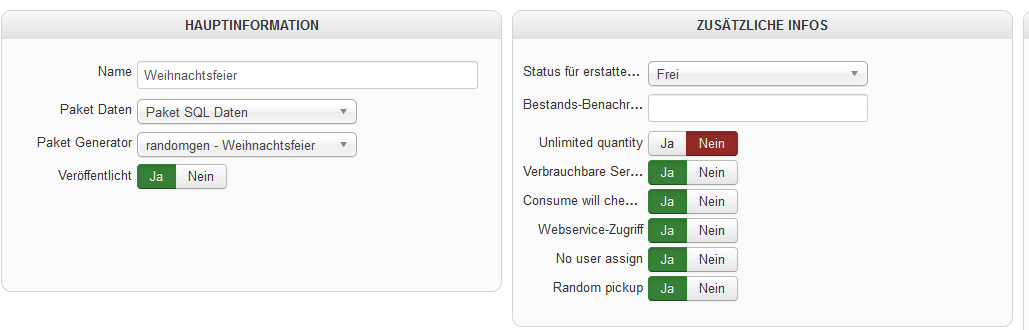

  • Posts: 26386
  • Thank you received: 4078
8 years 10 months ago #282060
Unfortunately, you're not using the right settings.
Please look at the documentation ; you will see that it's talking about "packs" and "groups".
So you should not touch the "Access Level" settings which is a common setting for all HikaSerial plugins.
But you should just configure the setting "groups" as explained in the documentation.
Regarding the "Access Level" one, you have to reset it (and check all).
Afterwards, if you follow the tutorial : www.hikashop.com/support/documentation/2...ticket-tutorial.html
You will see that the setting "Consume will check/assign user" is not set accordingly.
