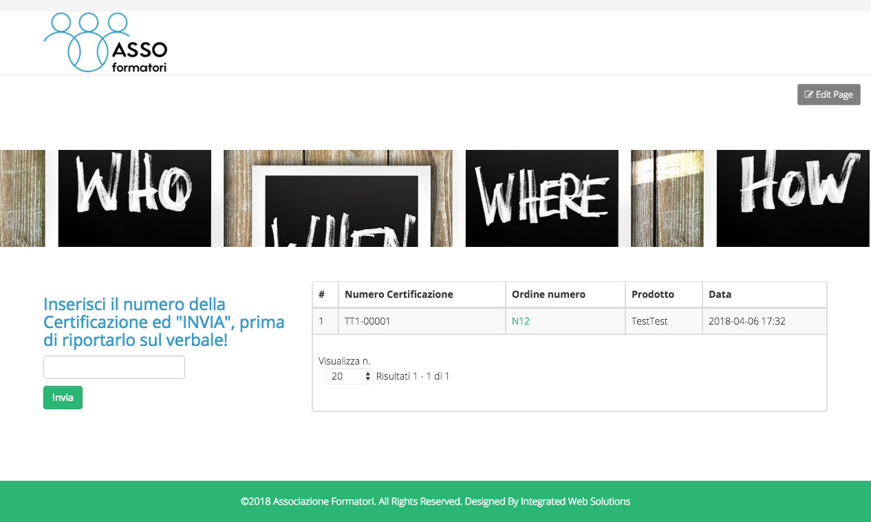

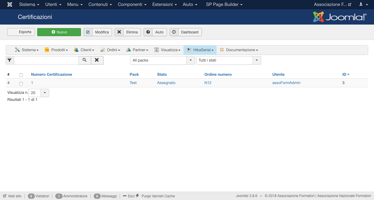

8 years 5 months ago #291022 by bassi
I'm trying to create a page with a table where user can see his serials, and the module to consume the serials.
The first issue I found is the serial number, as you can see in the screenshots I added, I created test serials with a simple code (TT1-00001) but in the backend I saw as serial number just "1".
Maybe I forgot something in the configuration...
Thank you.

8 years 5 months ago #291024 by Jerome
You're using the "series" generator ; so the serials are just simple number.
You can customize the display via the plugin to "format" it but, the serial content will still be a simple number.
And that is that very precise information which is required during the consumption.
Generally speaking, "series" are not meant to be used for consumption ; more for "lottery".
But if you want to use it ; you will have just one single pack available and you will have to put the number.

8 years 5 months ago #291214 by bassi
Hi Jerome,
I'm checking your suggested solution, and I think it will be a good solution.
Anyway I'm having a problem:
I created a page where users can see their serials table on the right side and the consume module on the left.
I'd like they put their serial in the consume module field and submit to consume it, after that the page shouldn't change, because it's probably that they should consume more serials in the same time. Is it possible?
Also I saw after consume submit, the website go to the consume page but it change the template I chose.
More
8 years 5 months ago #291217 by Jerome
The consume module is not working in "ajax" mode ; it will submit the data into a "consume page" but there is no setting to select the menu ID (for the moment ; I'm working on it for the next release).
Right now, you can still see to perform a little "view override" of "serial / consume" to force a value for the "ItemId".
You can also see to override "serial / consumed_..." to perform a redirect to another page, like the serial listing.
