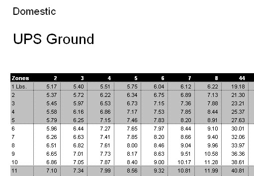

My client sells products weighing up to 100 pounds and ships via UPS standard ground to 10 different shipping zones. It looks like I will need to set up 100 x 10 = 1000 shipping methods.
If I worked quickly and were able to create 1 shipping method every 3 minutes, it would still take me 3000 minutes or 50 hours to create the 1000 shipping methods.
Can you suggest some easy way to do this?
How do other people bring UPS shipping data into HikaShop?

  • Posts: 92
14 years 1 month ago #17704
UPS divides the 40,000 US zip codes into 10 shipping zones and each zone has different shipping prices according to the weight of the package.
My client ships products that weigh from 1 to 60 pounds.
Given the above facts, I plan to manually input the entire UPS Standard shipping chart into HikaShop by following these steps:
*Create 10 shipping zones.
*Place all 40,000 zip codes into the 10 shipping zones by making the zip codes shipping sub-zones.
*Create 600 shipping methods (10 shipping zones x the weight of 1 through 60 pounds).
*For each of the 10 shipping methods, specify a shipping zone, a product weight and a price.
Questions:
1)Would this be the correct way to get all the UPS data into HikaShop?
Have I left out any steps?
2)How can I input a range of zip codes rather than all the individual zip codes?
What parameter or format should I use so that HikaShop recognizes zip codes as a range?
3)If I place all the zip codes into shipping sub-zones, will HikaShop then be able to recognize the zip codes and give the correct shipping price when customers type in their shipping address?
