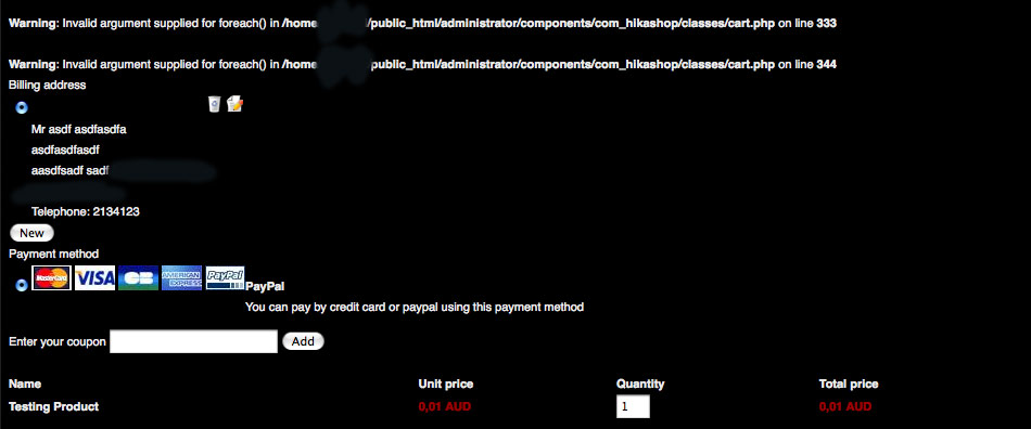

The Payment methods seems to be working but the errors are showing
Warning: Invalid argument supplied for foreach() in /home/xxx/public_html/administrator/components/com_hikashop/classes/cart.php on line 333
Warning: Invalid argument supplied for foreach() in /home/xxx/public_html/administrator/components/com_hikashop/classes/cart.php on line 344

I checked the code and we don't have a foreach on line 333 and 344. That probably means that you don't have the latest version of HikaShop. Could you update and try again ?
If you still have the error, could you copy/paste the new error message (at least the line number should be different) ?
