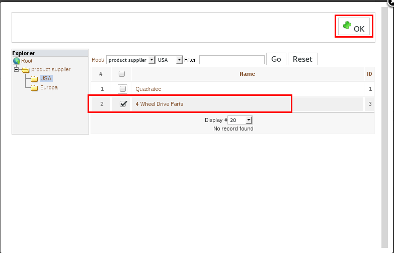

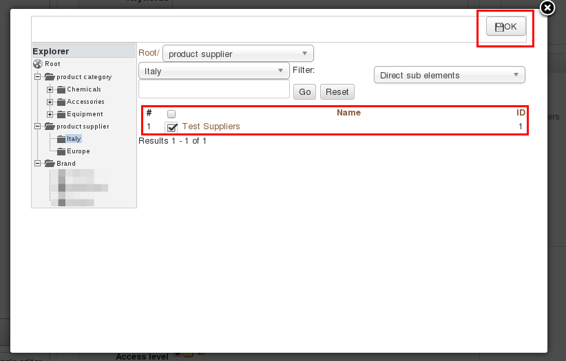

Hi, as discussed in the previous posts in the this thread, we customised Hikashop for a client, so that they could manage suppliers and supplier prices in the back end. As you can see in the first 3 attachments, clicking on add in the Suppliers box would open a window, in which the user could select the supplier for that product, clicking Add would close the window and add a new line in the Supplier box with the name and currency filled out.
We are now working to update this functionality for version 2.6.0, which has implements an improvement in the interface and code, but we are having some difficulties in getting it to work. So far we have recreated the supplier box. The HIKASHOP_ADD_SUPPLIER button opens a popup window to select the supplier. We have created a javascript addSupplier function which inserts a new line with the supplier name and currency. However when we click on "Ok" in the popup window we are having difficulty in understanding the new logic for firing the addSupplier javascript function to add a new line to the supplier box with the supplier details while closing the popup window.
Any help would be most appreciated.
Thanks, James

we have updated the addsupplier php function which is attached. I have a couple of questions:
1) how do we fire our addSupplier javascript function
2) is it better to get the supplier data first as in the attached php function and pass it to the javascript function or get the supplier data via ajax call in the addSupplier javascript function?
Thanks, James

we have the javascript function window.productMgr.addSupplier in the form_supplier.php file. When we run the function addsupplier which is in the file product/ view.hmtl.php we have
$js = 'window.hikashop.ready(function(){window.parent.productMgr.addSupplier({suppliers:'.$output.'});});';
But is it not firing this function. Are we getting this completely wrong?

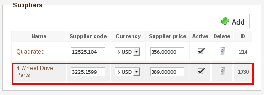

Okay we worked the logic out. We can open the popup window to choose the supplier and return to the parent window. The javascript addSupplier function is now being called. In our addSupplier function we are calling the hikashop dupRow javascript function to create a new row in the table.
Can we use the extraData variable in the dupRow function to insert the Supplier information we want to show in the new row? We could not find any example in the existing code where the extraData was used.
Thanks, James

your hint works perfectly, well almost perfectly ;) . We tried using it to pass the supplier currency id. In the followoing code
cho $this->currencyType->display($form_key.'[{id}][supplier_currency_id]', '{SUPPLIER_CURRENCY}' , 'class="no-chzn"');
The SUPPLIER_CURRENCY is replace by the supplier currency id. However php treats this value as a string not a numeric string or integer and so the right value is not shown as selected. Type casting or intval converts the string to an integer but as zero.
Do you have any suggestions? Thanks

Probably I have not explained the problem very well. We are using hikashop dupRow javascript to add and extra row in the product supplier table. The row we add is
<tr class="row<?php echo $k; ?>" id="hikashop_<?php echo $form_key; ?>_tpl" style="display:none;">
			<td class="hikashop_supplier">
				<input type="hidden" name="<?php echo $form_key; ?>[{id}][supplier_id]" value="{SUPPLIER_ID}"/>
				<a href="<?php echo hikashop_completeLink('supplier&task=edit&cid='.@$supplier->supplier_id); ?>">{SUPPLIER_NAME}</a>
			</td>
<?php if($acls['code']){ ?>
                <input size="10" type="text" name="<?php echo $form_key; ?>[{id}][supplier_product_code]" value="" />
            </td>
<?php }
	if($acls['currency']){ ?>
            <td class="hikashop_currency"><?php
				echo $this->currencyType->display($form_key.'[{id}][supplier_currency_id]', '{SUPPLIER_CURRENCY_ID}' , 'class="no-chzn"'); ?>
            </td>
<?php }
	if($acls['price']){ ?>
            <td class="hikashop_price">
              <input size="10" type="text" name="<?php echo $form_key; ?>{id}][supplier_product_price]" value="" />
            </td>
<?php }
	if($acls['active']){ ?>
            <td align="center">
               <input type="checkbox" name="<?php echo $form_key; ?>[{id}][supplier_active]" value="1" <?php echo !empty($supplier->supplier_active) ? 'checked="checked"' : ''; ?> />
            </td>
<?php } ?>
            <td>
				<a href="#" onclick="window.hikashop.deleteRow(this); return false;"><img src="<?php echo HIKASHOP_IMAGES; ?>delete.png" alt="<?php echo JText::_('HIKASHOP_DELETE'); ?>"></a>
            </td>
        </tr>
We use the extraData to replace the variables {SUPPLIER_NAME}, {SUPPLIER_ID}, {SUPPLIER_CURRENCY_ID} with the data we get in our addsupplier function (in view.html.php of the product). It all works perfectly. For example we choose a supplier with USD as their currency, {SUPPLIER_CURRENCY_ID} is replace by the value '2'. However if we run a quick test in the function display of the currencyType class, dump_var($value) returns string(22) "2". The value is two, but the string length is 22! Which corresponds to the length of {SUPPLIER_CURRENCY_ID}. So when the Joomla code makes a comparison of the key with the value although it looks like it comparing 2 == 2 really it is comparing string(1) "2" == string(22) "2" and hence it is not showing up as selected.
Any ideas how to make php "forget" the original string and evaluate just the value "2"?
