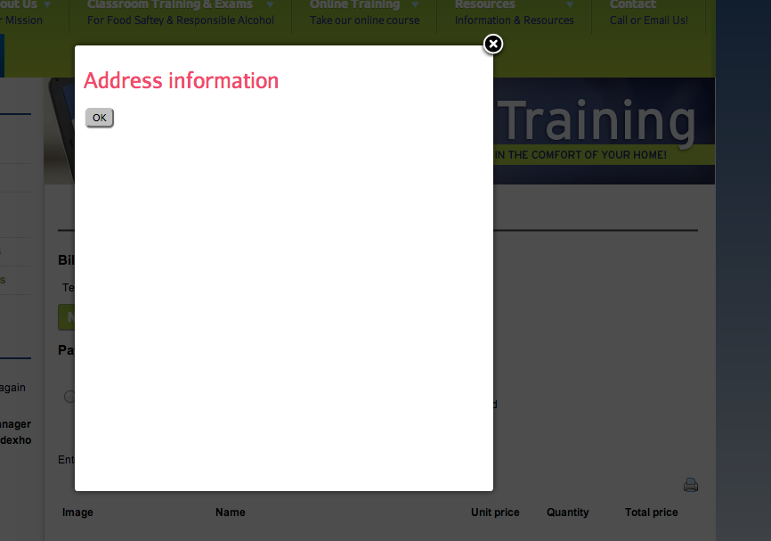

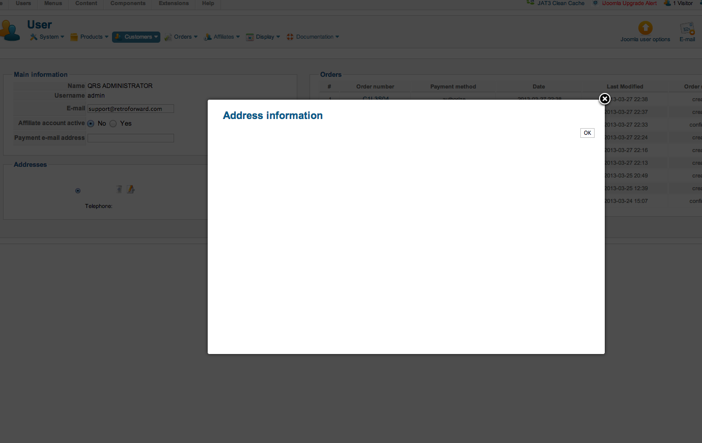

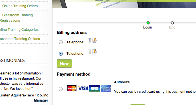

I am having trouble with address also. I am not sure if it related to this topic, but it seems similar.
Right now, there is no way to ever your address. when I click on the NEW button, the pop up is blank. it's doing it on the front end and back end. Please see the attachements. The only things I see is the word "address" and the "OK" button.
When I press the "OK" button, if create an entry for Telephone.
Hikashop is installed here: www.qrstraining.com/index.php/online/category . please message me privately for login details if you need to take a look. thanks.
I am stumped what is causing thing. Thanks in advance for any help you can provide.

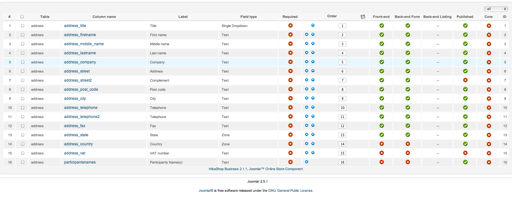

13 years 5 months ago #96792
this is how my fields are configured
13 years 5 months ago #96823

13 years 4 months ago #100682
I checked your settings and I see that you edited each custom address field via the menu Display->Custom fields and changed their access level from "all" to "custom" without selecting any use group, which means that they are accessible to no one and thus that's why you don't see them.
Please change their access level to "all" as it is by default and you will see your address fields everywhere as it should be.
