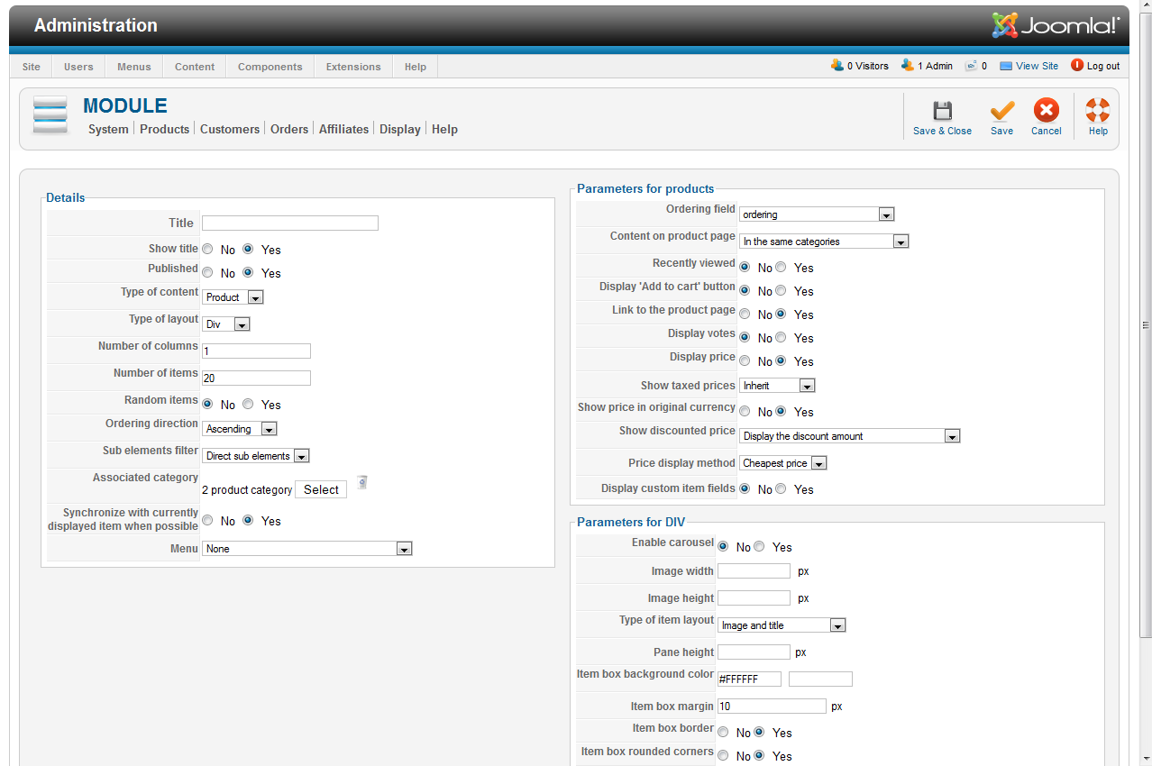

I tried that, but on my system when I select "Display | Content Modules | New" I get a different screen (attached).
Your example looks more like my "Display | Content Menus | New".
I have version HikaShop v1.5.8 with Joomla v2.5.6.
Is there some configuration setting I may be missing?

You need to configure your module in the same way as the module in our demo website. There is a link to it in the tutorial I gave you.
For example, you need to select "category" in "type of content", "list" in "type of layout", and turn off the "synchronize with currently displayed item when possible".
