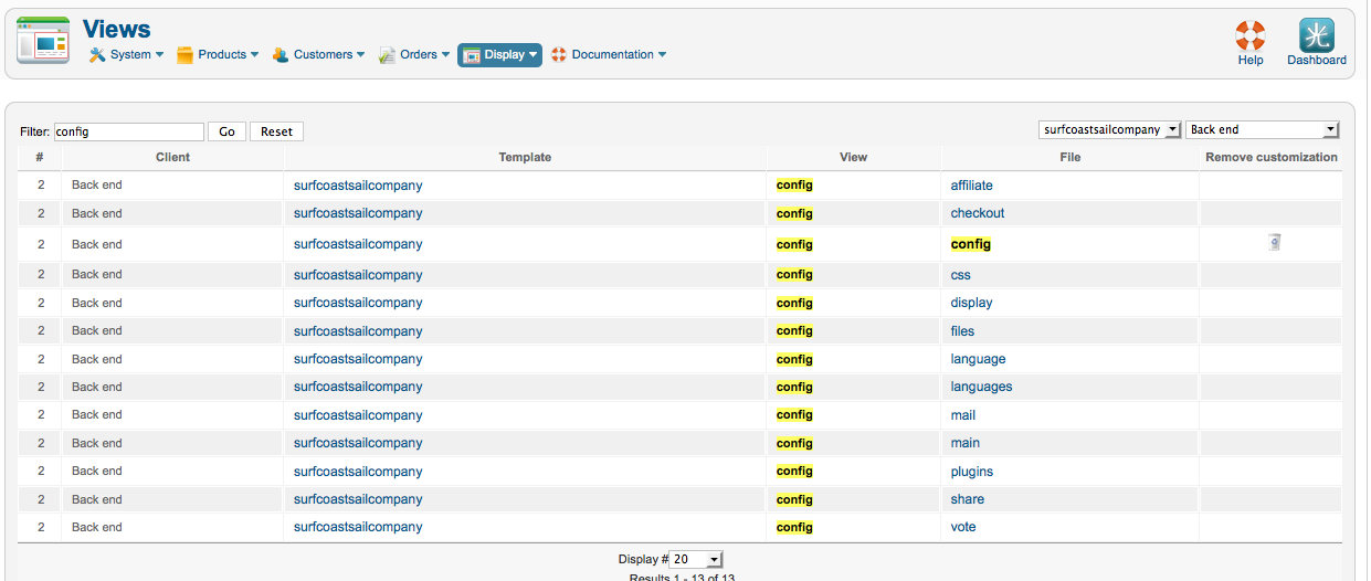

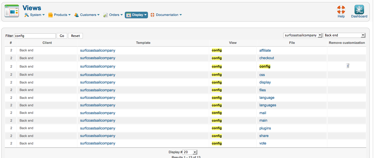

Thank you for your reply. Please correct me if I'm wrong. I've tried to remove enctype="multipart/form-data" from the file called 'form' in 'config' under 'view' in the menu of Display > View for my them of back end.
There is no file called 'form' in 'config'.. I have attached the screen capture. I tried remove enctype="multipart/form-data" from the 'config' file in 'config' under 'view' for my theme of back end. I still get an error of
Forbidden
You don't have permission to access /administrator/index.php on this server.
Additionally, a 404 Not Found error was encountered while trying to use an ErrorDocument to handle the request.
Should I ask to my hosting company for mod_security logs?
  • Posts: 26387
  • Thank you received: 4078
13 years 11 months ago #70153
Are you sure that the template you use in the backend is "surfcostsailcompany" ?
I think you are using "bluestork".
And right, there is no file "form" for config, "form" is for the view email.
Please edit "config | config" (like explain in the beginning of this thread).
