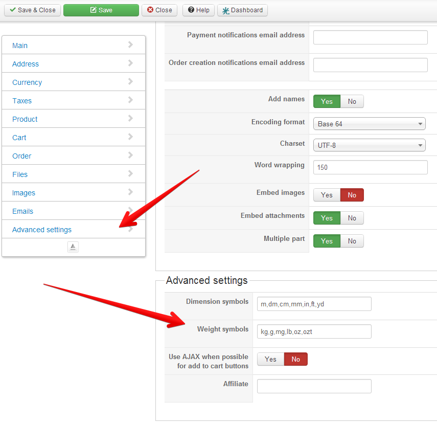

  • Posts: 7
13 years 5 months ago #93182
I have this working, but my weight shows up in Kilograms instead of pounds. For instance one of my products weighs 4 pounds, but shows up as 1.81436948 KG. Is there a way to change this?
Thank You
  • Posts: 86081
  • Thank you received: 14189
13 years 5 months ago #93290
What is working ?
Several different things have been posted on that thread so I don't know about which one you're talking.
If you're using pounds and that you see a weight in KG, it's probably because your main weight unit in the configuration is KG and not the pound. Change that and that should display you the weights in pound (the first one of the units in the list is the main one).
The following user(s) said Thank You: MikeC
  • Posts: 7
13 years 5 months ago #93314
Sorry....
I entered this text to display the weights in checkout:
echo $row->product_weight;
You say the "main weight unit in the configuration". I have looked all over for the setting for this. Can you point me in the right direction?
Thank you
  • Posts: 86081
13 years 5 months ago #93477
It's at the bottom of the main tab of the configuration
