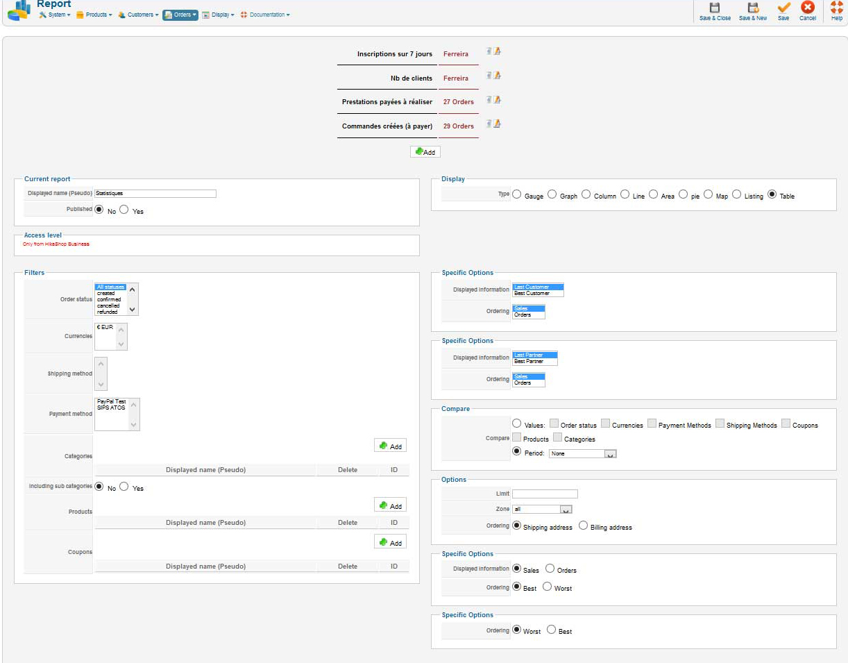

Nicolas, this table widget is really problematic, and I loose my face with my client :
- the widget is unpublished at each save,
- I can't add more than 4 lines, if I click Add icon I get the 5th that is not added,
... and it replace one item of the table !
- options on Customers do not save, it's still "Last customer" option which is saved,
- What are : Specific options, Compare and Options of the table for ?? I understand them for an item, but not for the table !

I made the update, but I still have problems with this Widget.
When I edit my existing table :
- the "Save" with OK button do not close or save the changes, when I edit a field
- the "Add" button edit the 2nd line. And I'm in the previous situation (no save).
I deleted (once more) my existing table widget, and it's still not working properly, when I create a new table :
- when I add a widget and select "Table" display, a popup with "Please configure your first row" appears.
After configurations, when I click on "OK" button, there is no effect.
If I click on the cancel "X" after the save, the row is not saved.
Thanks for help !
