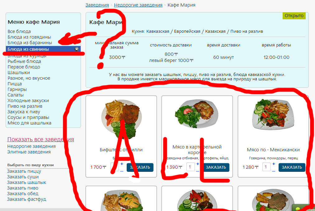

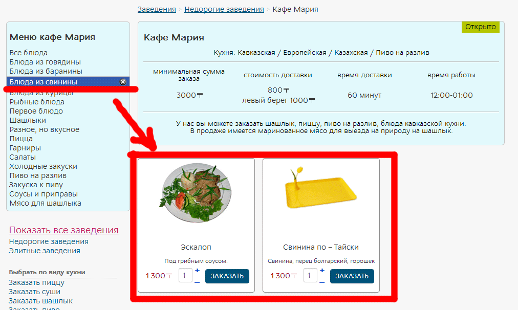

13 years 1 month ago #114061
Eliot wrote: Hi there,
Actually this is the current behavior of the filters, it's reseted for each category.
Could you please give me a link to your website so I can test it?
It's in russian. I think you don't understend anything on this site.
When I use filter, it works and show for example 2 products from category
But when I change category and then return here again, there will be listed all products, but filter module shows like filter is still applied. But really no filter is applied.
