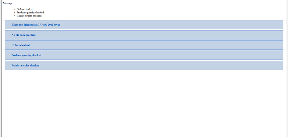

  • Posts: 69
12 years 2 months ago #99571
The out of stock plugin is enabled and the period is 3600 and stock limit is 0.
Attached is the manual cron task confirmation.
  • Posts: 26255
  • Thank you received: 4041
12 years 2 months ago #99626
The plugin work with "exclusive". I mean, it check products which have a quantity lesser than... 0
I have modified the plugin on our side to be "inclusive", it is more logical.
You have to edit the hikashop plugin "out_of_stock" and change this SQL query from
$query='SELECT * FROM '.hikashop_table('product').' WHERE product_quantity<'.(int)$this->stock_limit.' AND product_quantity!=-1';
To:
$query='SELECT * FROM '.hikashop_table('product').' WHERE product_quantity<='.(int)$this->stock_limit.' AND product_quantity!=-1';
And it would check products which have a stock of 0.
