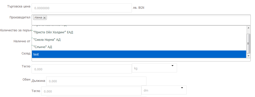

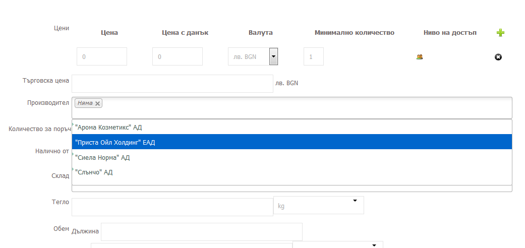

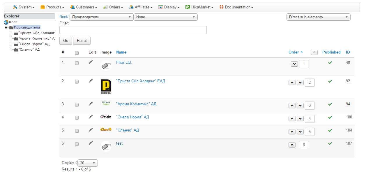

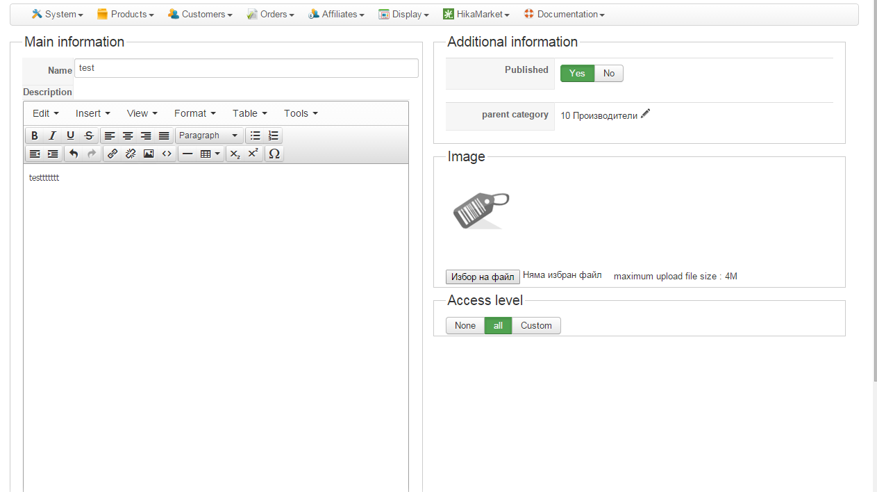

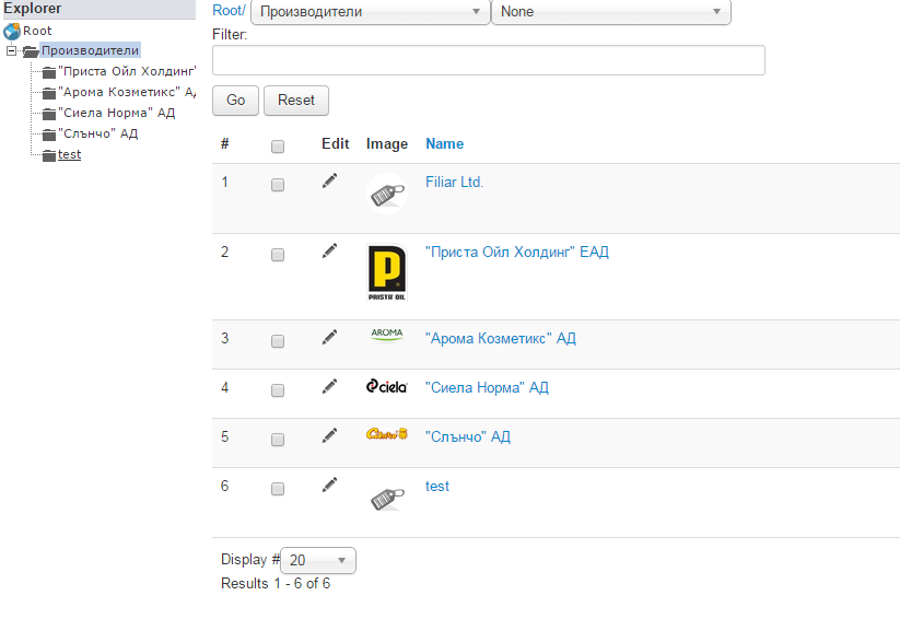

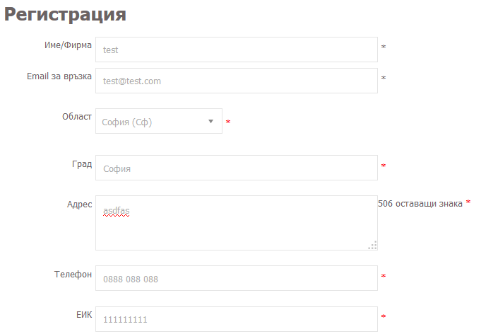

  • Posts: 134
  • Thank you received: 6
11 years 6 months ago #192027
1. Vendor "test" being registered
2. On prodict adding the new vendor is not present in frontend dropdown field
3. The product is not present on vendor page, because it is not assigned to the vendor
4. The vendor is not listed in the tree view in the left, but it is present in the grid
5. The vendor is being nodified from backend
6. The vendor is aleready present in the tree view in the left
7. The vendor is now available in the dropdown in the frontend product add form

11 years 6 months ago #192080
I'm trying your understand what you are doing.
The field after the MSRP is the manufacturer.
But a vendor is not a manufacturer ; you do not have to configure a manufacturer to associate the product with a vendor, the product is automatically associate with the vendor who created the product without any operation from anybody.
The vendor category is a category, it is not a manufacturer.

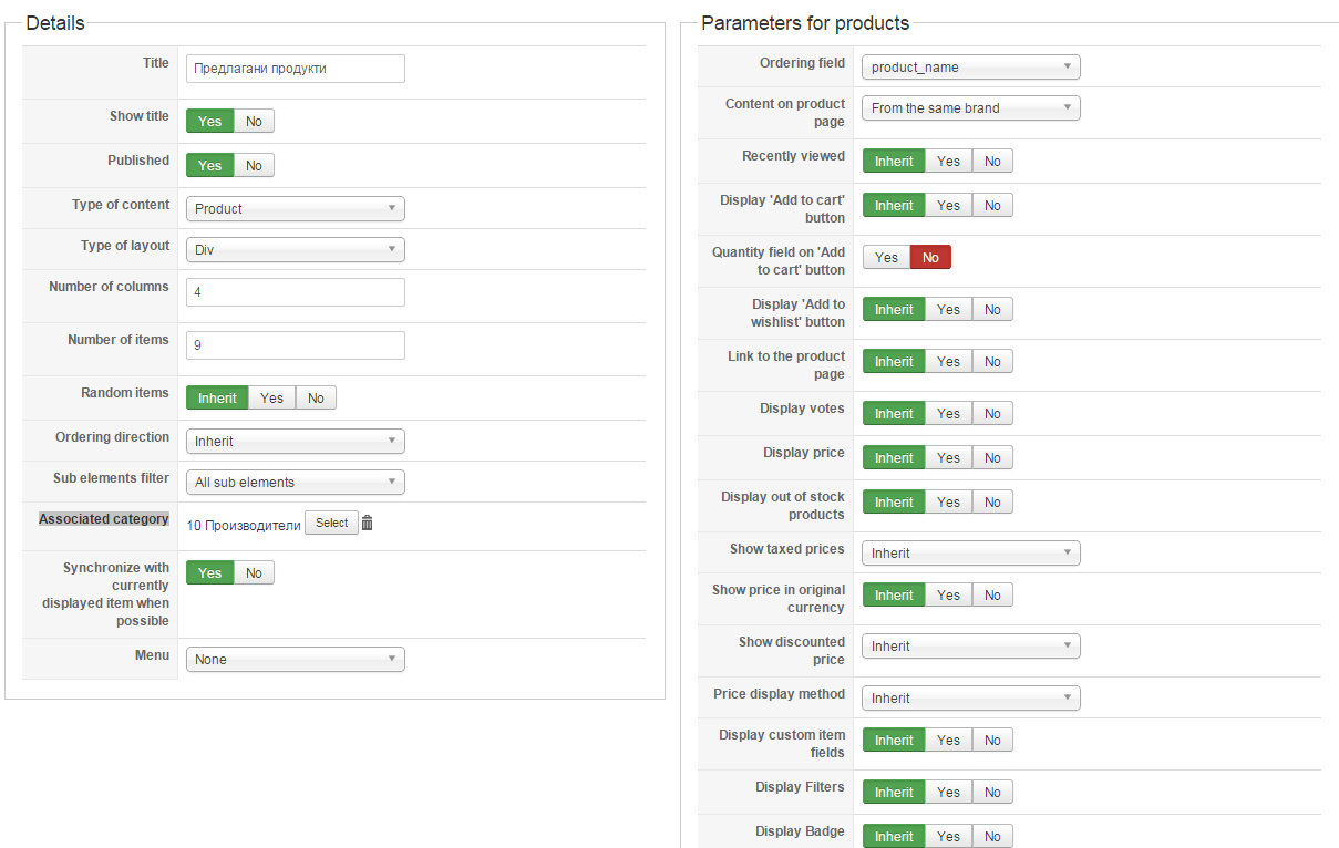

  • Posts: 134
11 years 6 months ago #192085
Then maybe I am doing something wrong.
I would like to make vendor product listing. So I have to create product listing module and select Associated category and select that module in "Modules under the vendor page".
But what should be the "Associated category" for that module then? I only could made it with selecting the "Vendor" category.
What am I doing wrong?
Last edit: 11 years 6 months ago by filiar.
  • Posts: 26385
  • Thank you received: 4077
11 years 6 months ago #192088
Let the default product category for the "associated category", you just need the option "synchronize with currently displayed item when possible".
It is working exactly like a product listing module under a category listing menu.
www.hikashop.com/support/support/documen...splay-front-end.html

  • Posts: 134
11 years 6 months ago #192184
Jerome wrote: Hi,
Yes, Jerome.
I've missed that. Now it works. I was confused, because in Bulgarian there is only one word for manufacturer and vendor and I couldn't find the logics.
Thank You!
