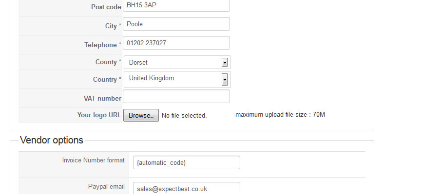

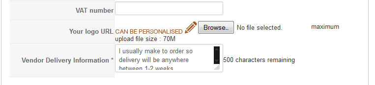

Hi I have a logo field for the vendor as i would like to display this at the top of their page however when i browse and upload an image it says it has saved with success however i cannot see any sign of the image on the front end or backend so i am not sure how to tackle it without looking to you guys to advise?

You have some javascript errors in your page.
You should have the dynamic uploader and not see this HTML upload input field.

I though you were talking about the "vendor image" which is above in the vendor page.

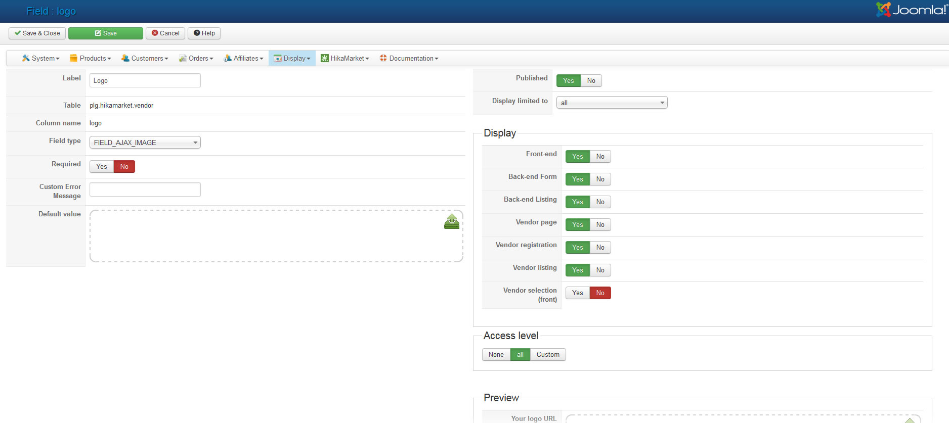

Could you please provide the screenshot of the custom field configuration ?
Maybe using the new custom field type, "ajax upload image", could be useful.
But the original "file" custom field should work so having your configuration will help us to try to reproduce your problem.

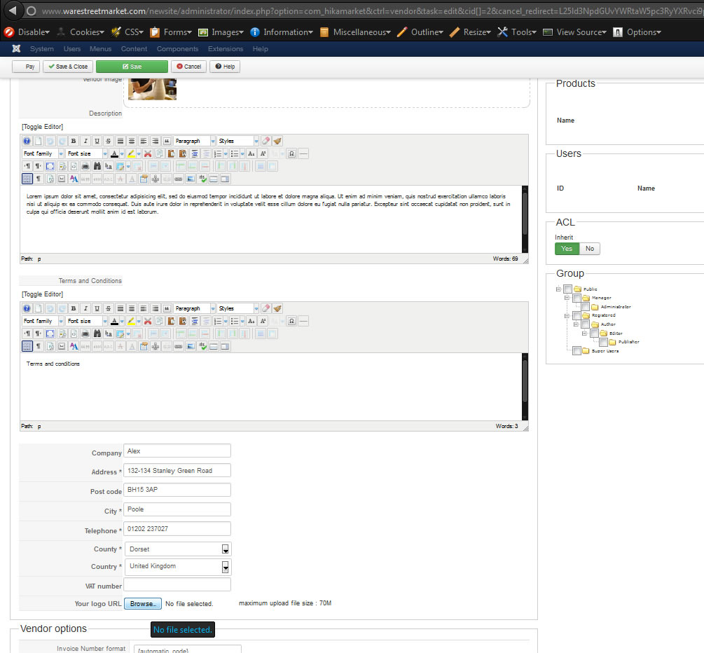

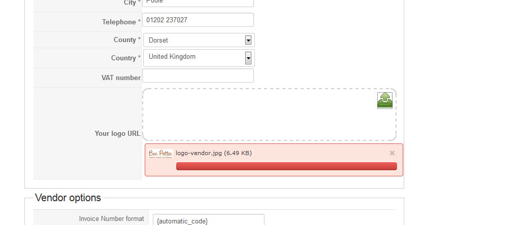

12 years 7 months ago #140848
Sure please find attached i have tried the ajax uploader which looks better anyway but just seems to stop once uploaded.

12 years 7 months ago #140972
I reproduced the problem and I was able to made a fix.
I will need more test in order to be sure that it is the right solution.

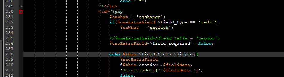

First, in HikaMarket, in the view "administrator/components/com_hikamarket/views/vendormarket/tmpl/form.php" replace
	$oneExtraField->field_table = 'vendor';
	$oneExtraField->field_required = false;
By:
	//$oneExtraField->field_table = 'vendor';

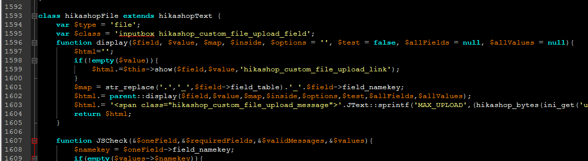

In HikaShop, for the class field ( administrator/components/com_hikashop/classes/field.php ) replace for "hikashopFile"
		if(!empty($value)){
			$html.=$this->show($field,$value,'hikashop_custom_file_upload_link');
		$map = $field->field_table.'_'.$field->field_namekey;
		$html.= parent::display($field,$value,$map,$inside,$options,$test,$allFields,$allValues);
By
		if(!empty($value)){
		$map = str_replace('.','_',$field->field_table).'_'.$field->field_namekey;
And

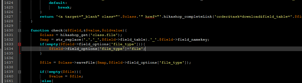

	function check(&$field,&$value,$oldvalue){
		$class = hikashop_get('class.file');
By:
And it will work for the classical file/image custom fields.

I am pretty sure i have done them all, i have attached screen shots of all the changes according to your 3 you mentioned previously. Please let me know if i have missed anything by mistake?
