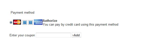

14 years 11 months ago #25091
Two of the four credit card symbols are not appearing in the checkout. Same result with any browser

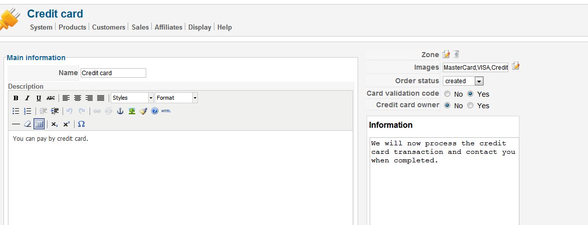

14 years 11 months ago #25106
Could you edit the payment plugin and do a screenshot of the images option ?
Could you try to reselect the images there with the edit icon ?

  • Posts: 86081
  • Thank you received: 14190
14 years 11 months ago #25109
In HikaShop, you have the menu System->Payment methods where you can access the payment plugins options.

  • Posts: 86081
14 years 11 months ago #25112
So it seems that you're missing some of the images in the folder media/com_hikashop/images/payment and that you don't use the latest version of HikaShop.

  • Posts: 52
14 years 11 months ago #26310
I have now updated to Hikashop 1.53 and the credit card symbols are still not appearing
You can see what happens by going to Hikashop on www.daltonwatson.com

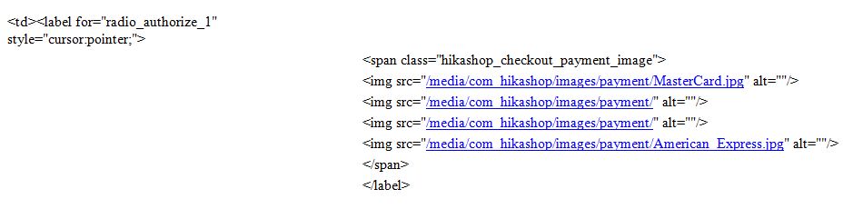

  • Posts: 86081
14 years 11 months ago #26319
The symbol are not appearing because you're missing the images in the folder media/com_hikashop/images/payment
I don't know why it didn't but the install should have added then back when you updated. You must have some access rights issues.
The simplest will be to open the hikashop install package and extract the folder media/images/payment and upload the files in there via FTP to your folder media/com_hikashop/images/payment.
  • Posts: 52
14 years 11 months ago #26361
does this image help to define the problem?
  • Posts: 86081
14 years 11 months ago #26372
No, I already saw that in the HTML of your page.

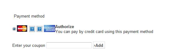

  • Posts: 52
14 years 10 months ago #26661
No other path I can take to correct?
  • Posts: 86081
14 years 10 months ago #26680
With the new release of HikaShop 1.5.4, you should not see the two non existing images anymore. But if you want to use them, you will still have to add them manually via FTP as explained in my previous post.
