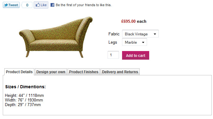

As another issue, the option doesn't seem to list anywhere on the page?
Where are options supposed to be displayed? :huh:
I have attached my view Product > Show.php in case its something in there which i causing the issue.
Create your own style of luxury bespoke furniture online

  • Posts: 152
14 years 11 months ago #25635
I don't think so since I simply run a find-replace-all for field $option to $optionElement
That is the only modification I have made in that view. File attached.

14 years 11 months ago #25640
I checked your product on the back end and there is no option configured:
/administrator/index.php?option=com_hikashop&ctrl=product&task=edit&cid[]=15
  • Posts: 152
14 years 11 months ago #25641
...doh.
I didn't realise you needed to hit the product save button after hitting the 'ok' button in the product options squeezebox.
sorry for wasting your time!!
