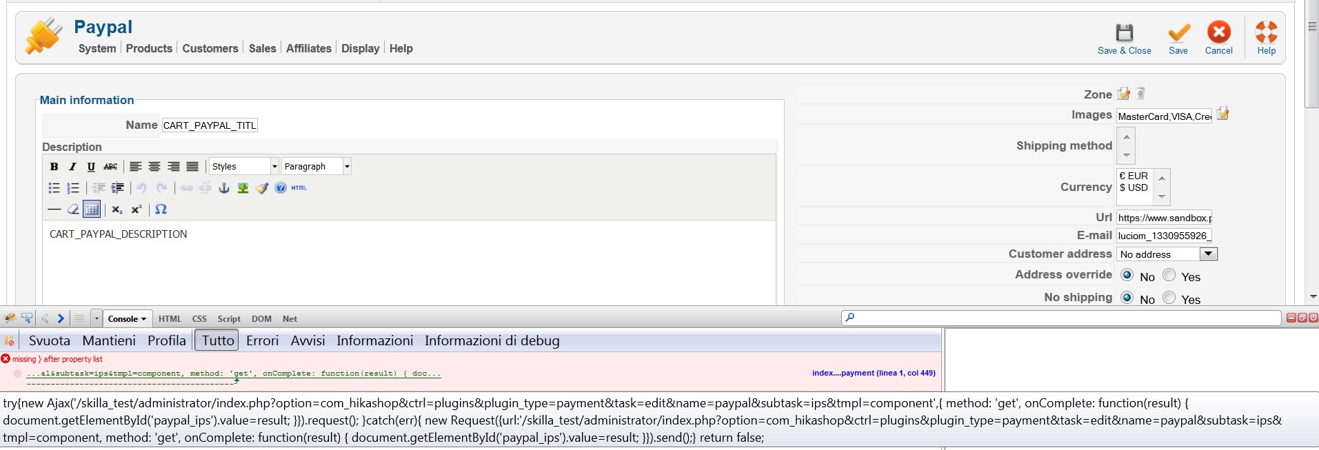

14 years 6 months ago #42865
Still can't get the notification back from Paypal...
Thinking now I'vent' listed proper sandbox paypal Ip's to get the IPN:
When I try a REFRESH I get the error I've attacched on the screenshot.
