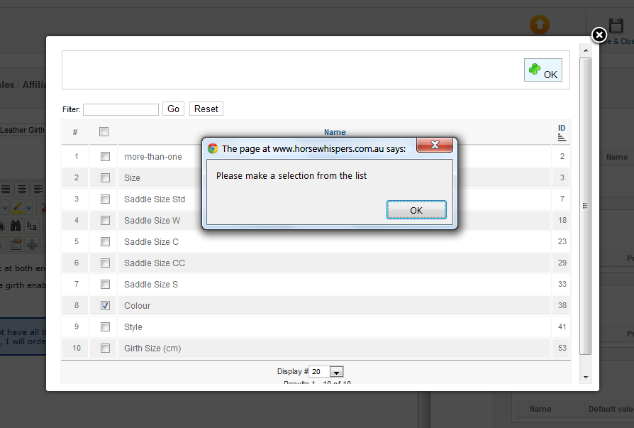

For example, when adding a variant, the same message comes up.
I've attached a screenshot

That should work if you use HikaShop 1.5.6 as it was one of the problems we fixed in that release to be compatible with Joomla 2.5.
Are you sure that you're using HikaShop 1.5.6 ?
