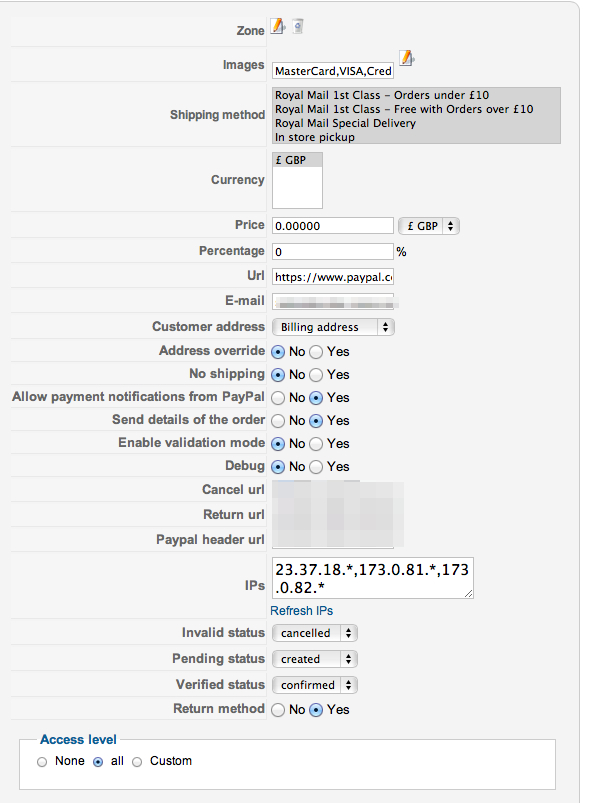

  • Posts: 74
13 years 7 months ago #86499
Thanks for replying.
Yes the "send details" button is selected. See attachment.
So I dont need to make this amend to the plugin then? >>
/* if($price_check != @$vars || $currency->currency_code != @$vars){ */
if($price_check > @$vars || $currency->currency_code != @$vars){
Here is the email I got >>>>
A Paypal notification was refused because the amount received (141.46GBP) is different from the order amount (141.45GBP)

  • Posts: 86080
  • Thank you received: 14186
13 years 7 months ago #86578
The error comes from the fact that PayPal calculate differently the taxes/prices. If you turn off the "send order details" option of the PayPal plugin, that error should not happen anymore as PayPal will only get the total of the order and process the correct price.
