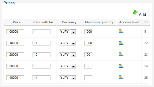

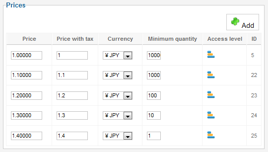

I have an issue with Japanese Yen in Hikashop. When creating multiple prices for different quanitites for an item with the currency set to JPY, Hikashop is only selecting the one price no matter what quantity is entered. This issue appears to happen to JPY only.
This pricing scheme works with other products but not if the currency of the product is set to JPY.
Is there anything I can do to fix this?
I have attached 2 screenshots, one of the product with the currency set in JPY and one of the prices column from the products list (JPY is different to the rest even with the same pricing scheme).
Daniel

That's normal. There is no cents in japan. Prices are round.
So, in the menu System->Currencies, if you edit your yen currency, you'll see that there is an option for the number of decimals which is set to 0. If you want to have cents, you can change that option.
