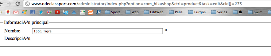

I had a bug in 1.5.6, but i update to 1.5.7 and the bug continue:
I can't edit and create categories, products and plugins.

That comes from your HTML editor.
Please change it with the "editor" option of the configuration of HikaShop and it should then work.

It doesn't work!
I change 3 options of editor in hikashop configuration (Tiny, JCE, no editor) and doesn't work.

Then it must be coming from an editor plugin. Could you set the "error reporting" to "maximum" in the joomla configuration so that you can see the error message when you edit the products ?

I put yes in error reporting and nothing appear to edit products.

And did that solve the problem ?
In any case, that's not a problem of HikaShop but from an editor/editor plugin on your website.
  • Posts: 37
14 years 4 months ago #47598
Yes, it is not a bug, problem is the joomla.
Thanks!!!!
