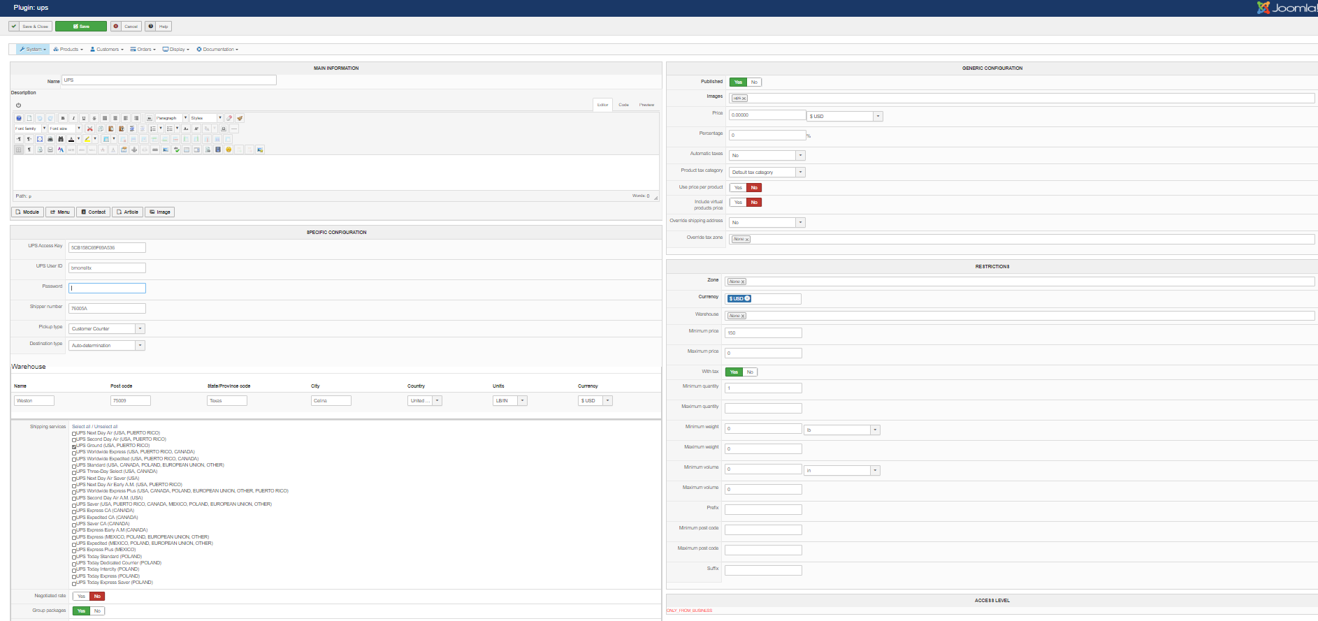

14 years 5 months ago #47330
I am using Hikashop Essential 1.5.7. The UPS Shipping Plugin is enabled. I have my cart configured with Shipping in the Workflow. All published products have a weights. I checked the tables and the weight units (lb) match the unit type designated in the shipping plugin (lb). My UPS account information is configured. However the UPS Shipping options are not presenting upon checkout. No error messages are presenting so I do not have a php error log.

  • Posts: 86212
14 years 5 months ago #47334
It's hard to say without knowing the options you use.
One thing which is important is to not only provide the weight but also the dimensions of the products with also the correct unit.
Also, check that the first unit of weight/dimension in the configuration of HikaShop is also the one you're using.
Also check that you're logged in with a valid address selected when you test.
If that still does not solve the problem, please provide a screenshot of your ups shipping method options (hiding the credentials).

  • Posts: 86212
14 years 5 months ago #47436
In your UPS shipping method's options screenshot, I see that you have two USA zones. One with the id 223, which is the default one in HikaShop, and one with the id 4508 that you must have added yourself.
That's probably why it doesn't work. You limit the shipping method to both zones. But the address of the user can only possibly use one of them... So it's not possible that the shipping method displays.
Please remove both zone restrictions in your UPS plugin options and try again.
  • Posts: 51
14 years 5 months ago #47451
If I understand your instructions I should remove a Zone from the Warehouse section in the Shipping Method.
The Zone has been removed. The duplicated Zone 4508 has been deleted from the Zone configuration. Out of desperation, and the assumption that setting a Zone was necessary, I duplicated the 223 zone and gave it a Type of Shipping Zones.
I am still receiving the "No shipping method found" message.

  • Posts: 51
14 years 5 months ago #47591
I managed to get it working. One of the UPS options chosen was Worldwide Expedited. After I deselected that option the shipping module seems to be working.
