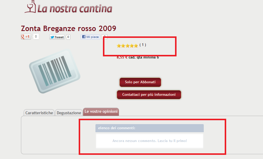

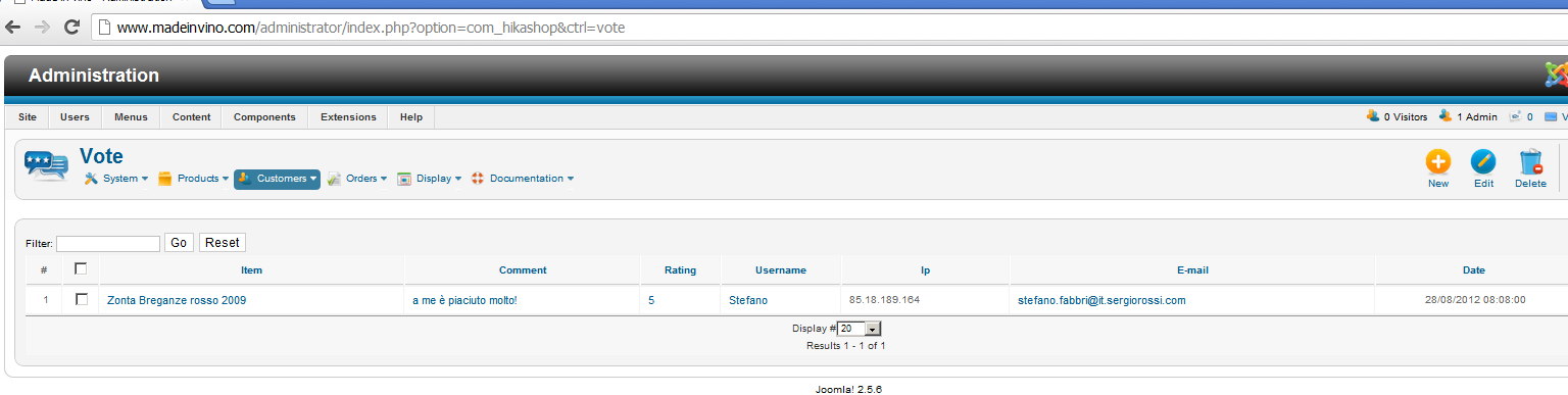

i installed the last release of hika 1.5.9
Today I found a problem with the comments and votes.
I selected the option to connect vote and comment.
I inserted a new comment, then i can see the stars but not the comment
this is strange, until last week it was fine.
is it a problem of the new version or something else?
Thanks and regards.

to move the comments in another tab i used the Tabber v2.1.3 plug-in and i modified the view "product / Show default" and "product / show".
To do that i followed the instruncton of this post www.hikashop.com/en/forum/4-how-to/56993...on-product-page.html
Until last week everything was fine.
I didn't modify the view show_tabular
I didn't change nothing, on monday I installed the new versione 1.5.9 and yesterday i verified I cannot see the comments.
Do you have any ideas?
