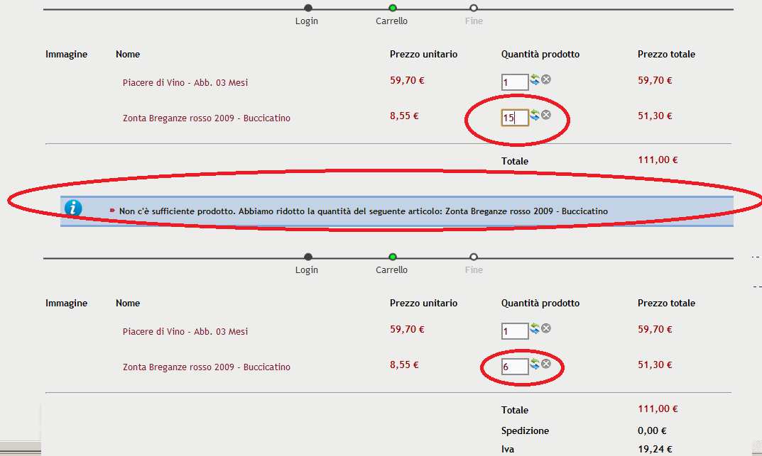

I am using the versione 1.5.9 of Hika and i have a problem with the "limits".

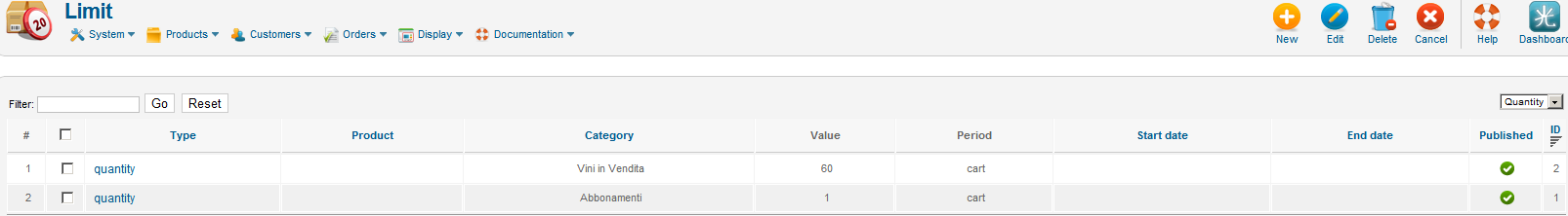

I defined 2 limits for the CART:
- maximum 1 subscription (category "Abbonamenti")
- maximum 60 bottles (Categlry "Vino in vendita")

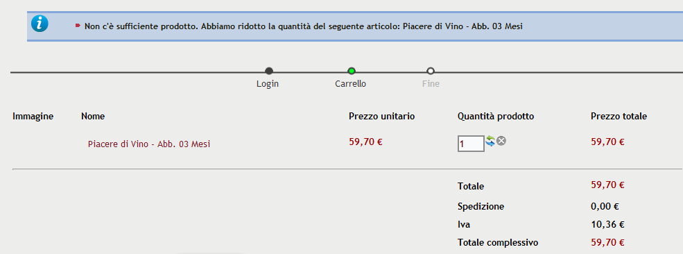

when I try to insert more than one subscription Hika works fine and retreive to me the right message
If I add a wine where the minimum is 6 everything is fine but when I try to increase the qty to 15 the system gives me an error and then set the quantities to 6. :dry:

Can you do a screenshot of that product' option page ?

Your products are not attached to the categories of your limits.
Note that there is no "include sub categories" option (it would be too much resource intensive), so the categories that you use in limits will only work for products directly linked to them.
So you might want to create extra unpublished categories and add them to your products as second categories and use them for the limits.
