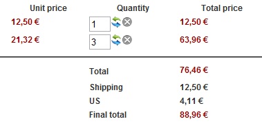

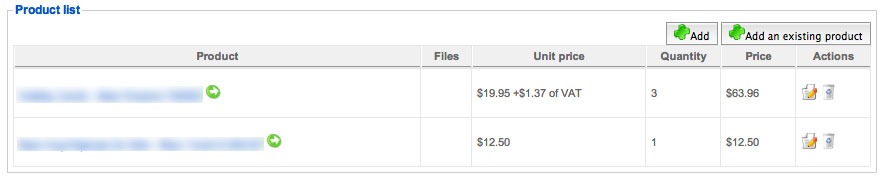

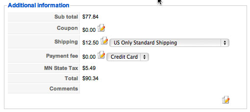

I am having issues with sales tax calculations. I have an order where I can't get the numbers to add to the total that the customer was charged, and what they were charged was wrong. The included screen shots show the information in the order.
The order is simple. Two items ordered. One item is taxable, and they ordered 3 of them. The other item is not taxable, and they ordered only one of them. The tax rate is 6.875%. Shipping is $12.50, and is not taxable.
From my calculations the tax should have been $4.11, not $5.49, the sub total should have been $76.46, not $77.84, and the order total should have been $88.96, not $90.34. Where is the extra $1.38 in tax coming from?
Anyone have any thoughts? I am stumped.

I tried on my end and it's working here.
Do you have the last version of Hikashop? Also are you sure your product are configured as you said (especially for the non-taxed product and the non-taxed shipping method).

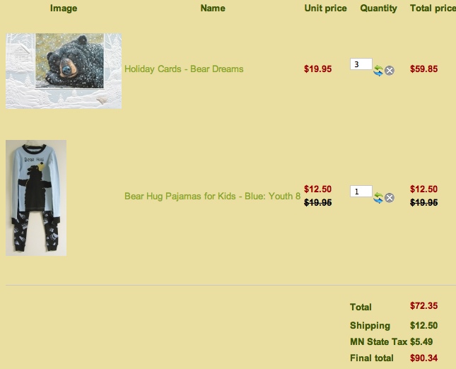

I think I found how the math is working now, but I still don't understand why.
One product, the one selling for $12.50 actually has a discount on it. The regular price is $19.95. If I add $19.95 and the other merchandise before taxes which comes to $59.85, I get $79.80. If I calculate tax from that amount, I get $5.49, which is what the customer was charged.
I feel confident that I have figured out what happened, but I don't understand why, as the discounted item has a tax category of none. It does have three variants as there are three sizes, but variants don't have a tax setting, so it isn't something buried in there.
Any thoughts as to why that one item would be taxed, when it is not set to be taxed?

13 years 11 months ago #66244
I just downloaded 1.6.0 again installed it. I then built up the cart just as that customer had, and proceeded to checkout. The tax amount is still wrong. It is still including the before discount price of that item in the tax calculations.

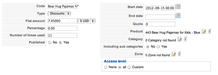

Could you please send me screenshot of your discount?
It seems indeed that we have a bug there, I'll try to fix it :)

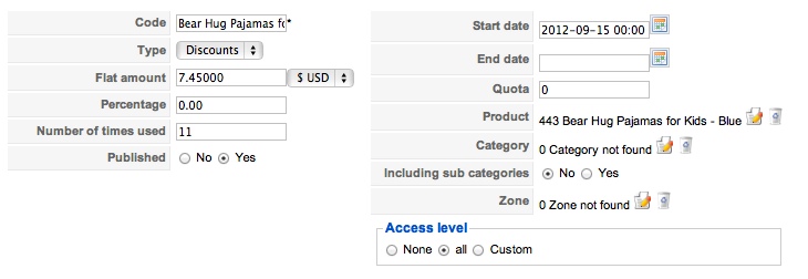

Here is a screen shot of the discount. It is a very simple one applied specifically to that product.
