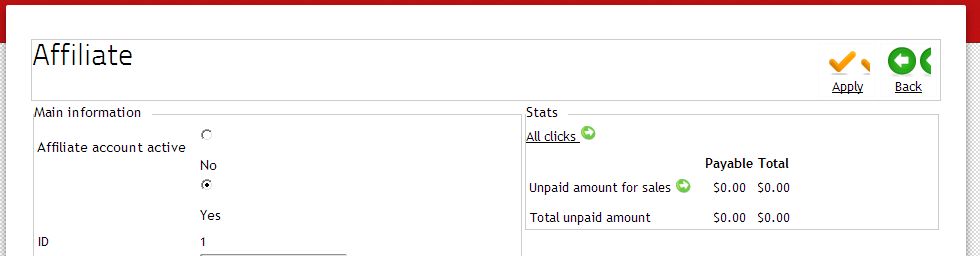

I have just set up the affiliate page and have experienced some display issues with the icons (duplicating) and the yes/no radio buttons are not inline (no and yes under the buttons). I have attached a screen shot of the issues.
I have looked at the code but cannot find anything out of the ordinary that could cause this.
Could anyone help me to fix this up?

This looks like a problem coming from the CSS of your template.
We would need a link to that page and a user access in order to see that page's CSS/HTML with firebug and be able to give you some help on fixing the CSS.

I hope that you received my PM with the log in details? The page is found at www.powerpublishingclub.com/about-us/ind...ashop&ctrl=affiliate

That indeed comes from the CSS. You will have to add that CSS in order to fix the display:
div.toolbar span {
width: auto !important;
label, legend {
display: inline !important;
You can add it either in your templtate CSS or in the frontend CSS file of hikaShop via the Display tab of the configuration.

Thanks for your assistance. All is working well now.
