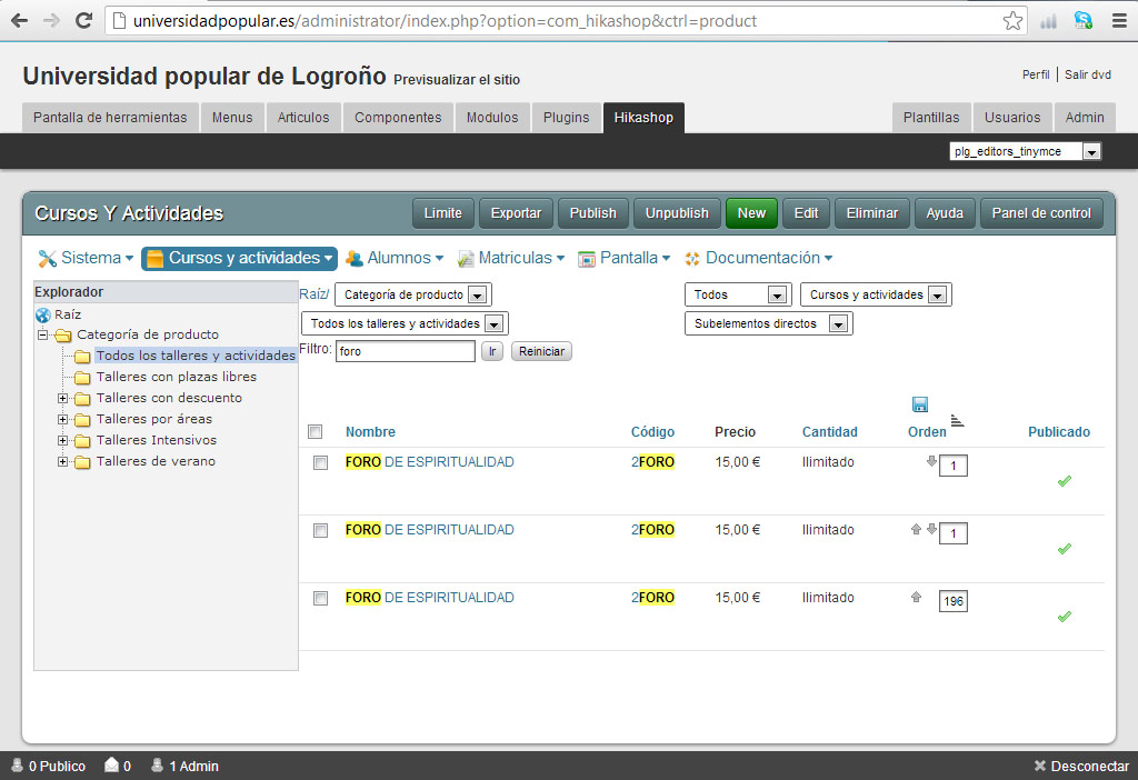

Hello:
When I upgrading to version: 2.0.0, I lost the product listing pagination in all categories.
You can only see 20 items.
Attachment screenshot.

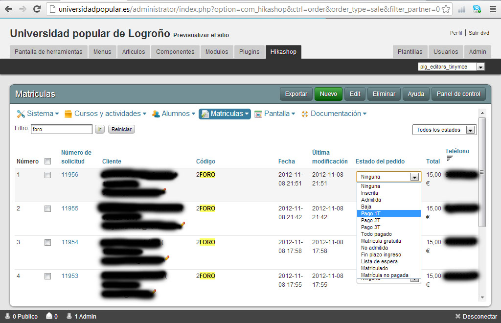

When I upgrading to version: 2.0.0, I can not change the status of the orders directly from the screen of orders.
Thanks!

It sounds like this comes from the fact that you're using a custom backend template.
Can you try to switch to the default backend template to see if that works ?
Do you have any javascript errors in the javascript error console of your browser ?

13 years 10 months ago #75459
The second issue "orders"is now fixed.
was caused by a change in the view.
thank you very much Nicolás
About the first problem:
I could not fix it, even changing the template.
in the error console appears, with the default template:
NodeType constants are not available. chrome-extension://lifbcibllhkdhoafpjfnlhfpfgnpldfl/global_constants.js:28
document.location = universidadpopular.es/administrator/inde...product&filter_id=12 chrome-extension://lifbcibllhkdhoafpjfnlhfpfgnpldfl/global_constants.js:29
thanks

  • Posts: 3
13 years 10 months ago #75462
I just spent half hour with the same problem and found out that it occurs when you squeeze the browser window too much. Try maximizing the window and the navigation will appear at the bottom, if your monitor is wide enough, that is.

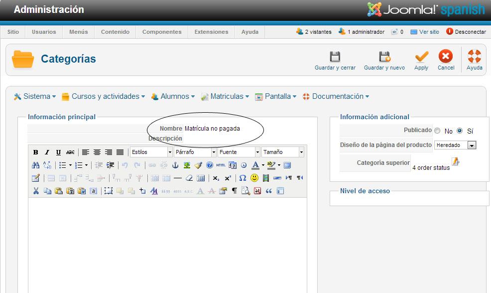

In system states, after the update, I can not edit the name of the state.
David

  • Posts: 267
  • Thank you received: 5
13 years 10 months ago #76571
Hello nicolas:
The field indicated in the attached file is not editable.
I can not change either the name or the description.
If I generate a new state, I can enter either the name or the address.
Sorry for not explaining properly on English and thanks for your answers

  • Posts: 26387
  • Thank you received: 4078
13 years 10 months ago #76826
So you're talking about "Order statuses", not "state" (which are countries' states).
You're screenshot display other information which shouldn't be display (like the parent category).
What url do you have for this page ?
How did you arrived to it ? (where did you click ?)

  • Posts: 26387
13 years 10 months ago #77080
I made a little mistake during my tests.
I have always Joomfish or Falang installed on my local websites and you don't use it.
Order Statuses should not be edited, you can create new one, you can delete but in general, we don't want to gives the possibility to edit it.
When you create an order status, the most important point is to know that, it is a "key" and not a "name".
You can override the name by editing the translation file.
CONFIRMED="confirmed"
CANCELED="canceled"
etc...
Now, if you really want to edit the order statuses, you have to do it directly in the database or by delete/create steps.
One thing important to know is that, all of your order could have a status, this status is a "status key", a string.
If you delete or modify a order status, all of your configuration could be broken and a lot of orders could have a non-valid order status.
That's why order status shouldn't be modified and translation should be use.
When joomfish/falang is used, the key is not touch, but it would provide different translations for the different languages. That's why the interface allow the edition when the plugin is installed.
Best regards,
