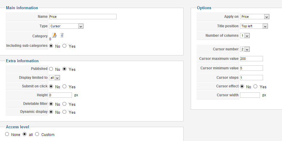

13 years 9 months ago #81158
Could you give us a screenshot of your cursor filter configuration ?

  • Posts: 29
13 years 9 months ago #81181
I've attached the screenshot.
  • Posts: 86183
13 years 9 months ago #81393
In the options of your filter module, you need to enter the id of the products listing menu which lists all your products. There, you can also turn off the filter button for the module.
As Xavier said, you can activate the automatic filtering, you need to turn on the "submit on click" option of the filter.
  • Posts: 29
13 years 9 months ago #81612
OK, I did this, but anyway it doesn't seem to be working... Btw, when I try to change category in filter config (as in screenshot), it opens new page in the same window and I can't assign a category to a filter. Is it a bug? Maybe this is a reason?

  • Posts: 86183
13 years 9 months ago #82165
You need to turn on the option "submit on click" in the price filter if you want it to refresh the page when you change it, otherwise, you would have to click on the "filter" button but that button has been removed on your module.
  • Posts: 29
13 years 9 months ago #82198
But it is turned on :(
  • Posts: 86183
13 years 9 months ago #82491
Ok. Replace the file administrator/components/com_hikashop/classes/field.php with the one in the archive enclosed and try again.
