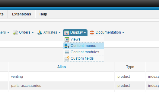

updated hika to 2.0 a few weeks ago and just now went to edit an existing filter created in 1.6, but...
i have no filter icon in display>filters
  • Posts: 26387
  • Thank you received: 4078
13 years 9 months ago #81464
Did you change some ACL access in the HikaShop configuration ?
If your account do not have access to filters, this item menu wouldn't be displayed.
If not, you could send us an access to your backend by private message and we would investigate and fix this problem for you.
  • Posts: 223
13 years 9 months ago #81471
have made no changes
i have pm'd user name and password for you
  • Posts: 26387
13 years 9 months ago #81473
The filter menu was displayed in your page but, the translation was empty.
So the item line was not displayed correctly.
I have removed your override translation for "FILTERS" and now the menu is displayed fine.
If you really want to remove the translation for "FILTERS", you can make some view overrides in your front end or edit the override of your backend menu.

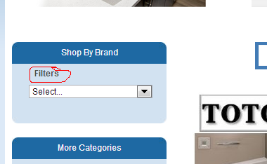

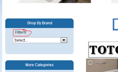

i remembered why....
i was trying to remove "filters" circled in red on front end...
this is a hikashop filer module
  • Posts: 26387
13 years 9 months ago #81490
I think that a CSS rule could hide the "Filters" text (which should be in a span).
  • Posts: 223
13 years 9 months ago #81736
that did it....
.hikashop_filter_fieldset legend{
display: none;
thanks
