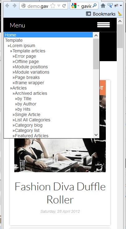

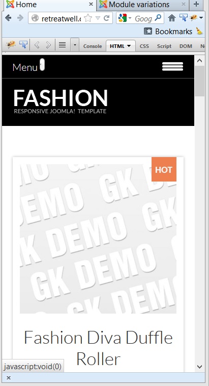

Dear Hikashop,
My menu problem persisted through the installation of a new template. The templates work fine, but as soon as I install hikashop, it breaks.
Here is my site: www.retreatwell.com/index.php
Working Template: demo.gavick.com/joomla25/fashion/ (may have to change to orange style at button for same appearance)
Attacked are files that illustrate the problem:
Last edit: 13 years 8 months ago by dynamicvitality.
  • Posts: 35
13 years 8 months ago #83590
Attached are images illustrating the exact problem
  • Posts: 26386
  • Thank you received: 4078
13 years 8 months ago #83696
HikaShop could call jQuery Chosen of the listboxes like the default J3 admin template does.
But some tests, chosen would not be compatible with your template, so you have to deactivate it.
Please add a configuration line into your database "bootstrap_forcechosen" with the "0" value, like explain in this post:
www.hikashop.com/en/forum/3-bug-report/7...component.html#78219
