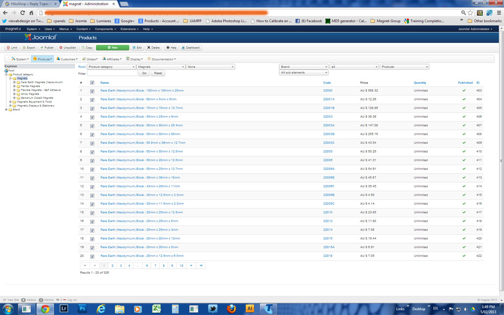

Hi guys,
I am having some issues with csv product export in Hika 2.0.0 in Joomla 3.0.
The export data does not seem to be product data - see attached
Export from the Joomla 2.5.8 version is correct but that latest looks strange.

There is a small bug in some cases with the export in the current version.
That is fixed on our end for next version of hikaShop.
You can simply remove the first few lines of HTML code in the file via notepad before opening it for now.
Here is your file fixed:

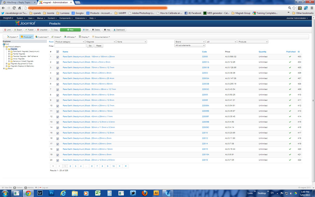

More on that is that can only export what can be selected (ticked) and in Joomla3 that seems to be only 20.
Is the option missing for pagination of results (i.e. 20, 50, 100, or all etc) for products?. (See Attached)

That's indeed the case.
The problem comes from the pagination override of the backend template of J3 which removes the dropdown.
If you rename the file:
administrator\templates\isis\html\pagination.php you get back the dropdown, but of course, you loose the styling of the template :/
I guess that we'll have to find a way to code around that for next version.

HikaShop 2.1.0 has been released, you can try it to see if it solve you problem.

Hi Xavier, yes it did.
Kudos to the Team!
