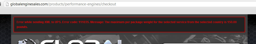

Error while sending XML to UPS. Error code: 111035
  • Posts: 36
13 years 7 months ago #89554
Error while sending XML to UPS. Error code: 111035. Message: The maximum per package weight for the selected service from the selected country is 150.00 pounds.
i'm getting this with the ups shipping module. most of my products are over 150lbs there any way around this?

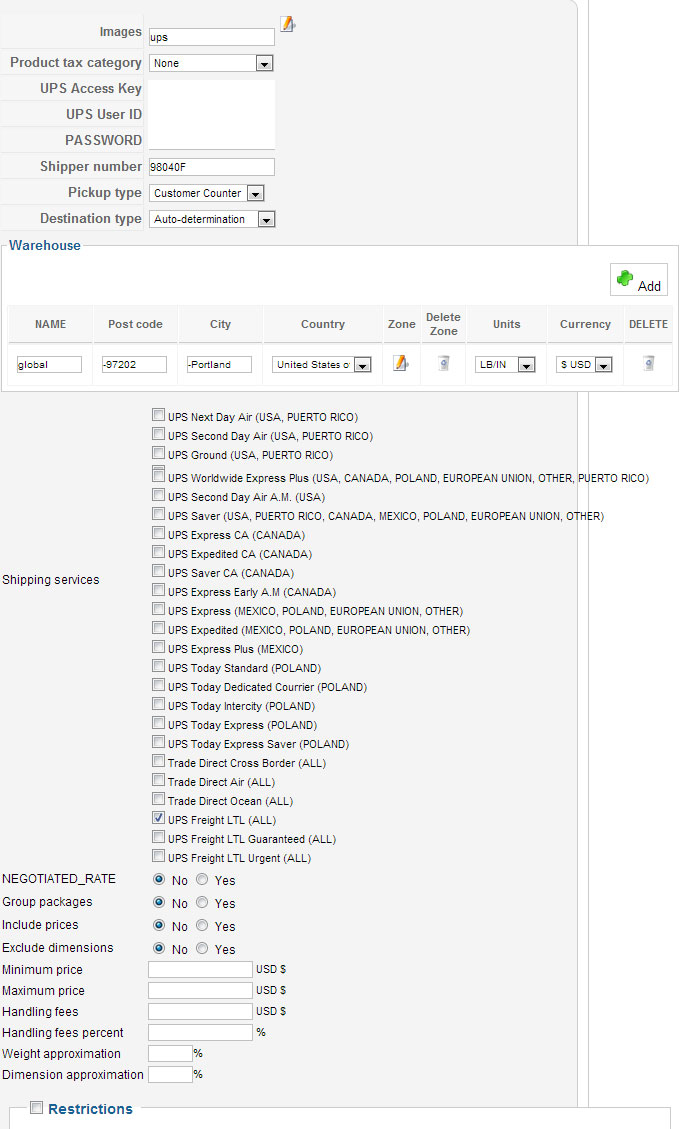

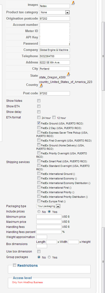

  • Posts: 86183
13 years 7 months ago #89883
Maybe the UPS method is not configured properly. For example, if you restrict it to the UK and that your user address is in the USA, you wouldn't get any results, regardless of the weight/dimensions of your products.
If you could do a screenshot of the options of your UPS plugin, we could check your settings.
The following user(s) said Thank You: ICwater
  • Posts: 36
13 years 7 months ago #89916
heres the ups and the fedex
  • Posts: 36
13 years 7 months ago #89966
cant get freight to show. got ground to show on a lighter item. but that price seems a little high. lol

  • Posts: 86183
13 years 7 months ago #90116
For the FedEx plugin, the configuration sounds ok.
For the UPS plugin however, you should remove the - at the beginning of the postcode. Otherwise, UPS will fail to interpret the post code properly. That probably explains why you don't get any rates with UPS.

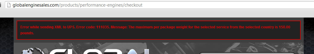

  • Posts: 36
13 years 7 months ago #91036
could you tell me how to turn off the errors being displayed at the top of the page?
i turned off display errors in the joomla config but they continue to display. also says cart empty up there when you delete an item. just dont want to see those messages.

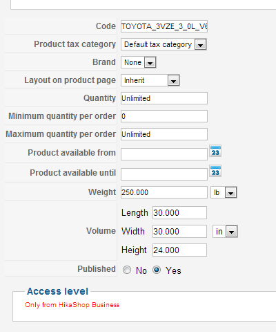

  • Posts: 36
13 years 7 months ago #91157
here ya go
i know it exceeds the max weight, but it gives me that message even though ups is not an option. i just want to turn those messages off.
13 years 6 months ago #91281
The solution would just be to unpublish the UPS shipping method through "Hikashop->System->Shipping methods", because this method isn't available because of your product's weight.
  • Posts: 36
13 years 6 months ago #91350
i have some lighter products that use ups. i figured it out though, was a setting in the template.
