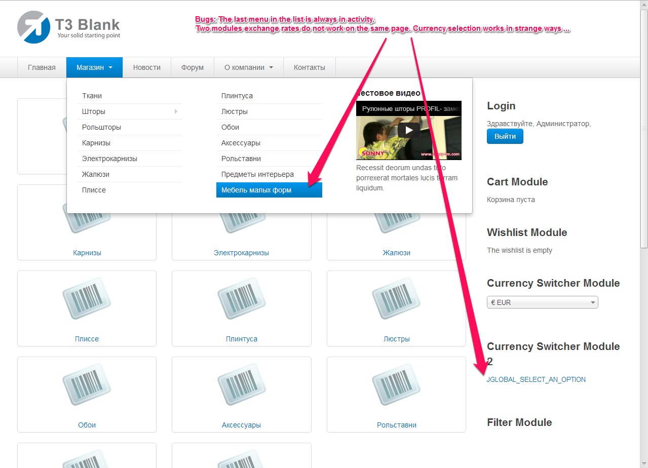

Hi all!
Joomla! 3.0.3, HikaShop Business 2.1.0, T3v3 framework.
I hope this picture explains the problem.
Part of the message is hidden for the guests. Please log in or register to see it.
Thanks in advance!
Vio.

The currency switcher module cannot be displayed twice on a page. It's normal that it doesn't work because the id of the dropdown are the same for both instances of the module. That has been the same since HikaShop 1.0.0
