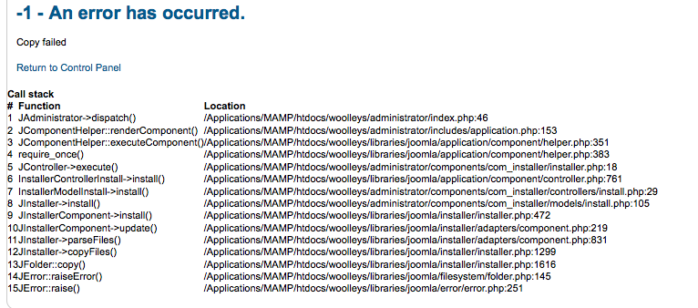

I just tried to update Hikashop essentials to the latest version 2.1.11
I have tried both the .zip and tar.gz files but I just get a copy failed message?
I tried to install another component ( Jevents ) and it worked fine..?
Im working on my local MAMP server...
Any Ideas?
  • Posts: 86081
  • Thank you received: 14190
13 years 5 months ago #95206
This means that the Joomla installer could not copy all the files of HikaShop because of access rights.
Try renaming the folders components/com_hikashop and administrator/components/com_hikashop before installing again to circumvent the problem.
