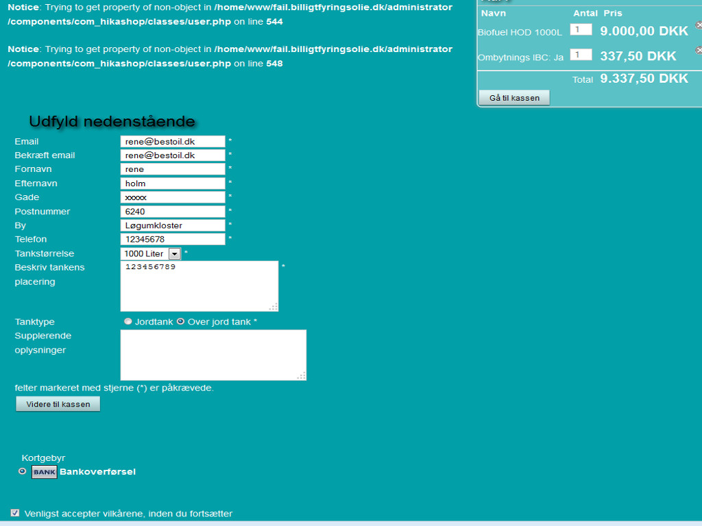

After upgrading today, i have a problem in the checkout
I can't go to further from the site where to insert address..
This is the fails
Notice: Trying to get property of non-object in /home/www/billigtfyringsolie.dk/administrator/components/com_hikashop/classes/user.php on line 544
Notice: Trying to get property of non-object in /home/www/billigtfyringsolie.dk/administrator/components/com_hikashop/classes/user.php on line 548

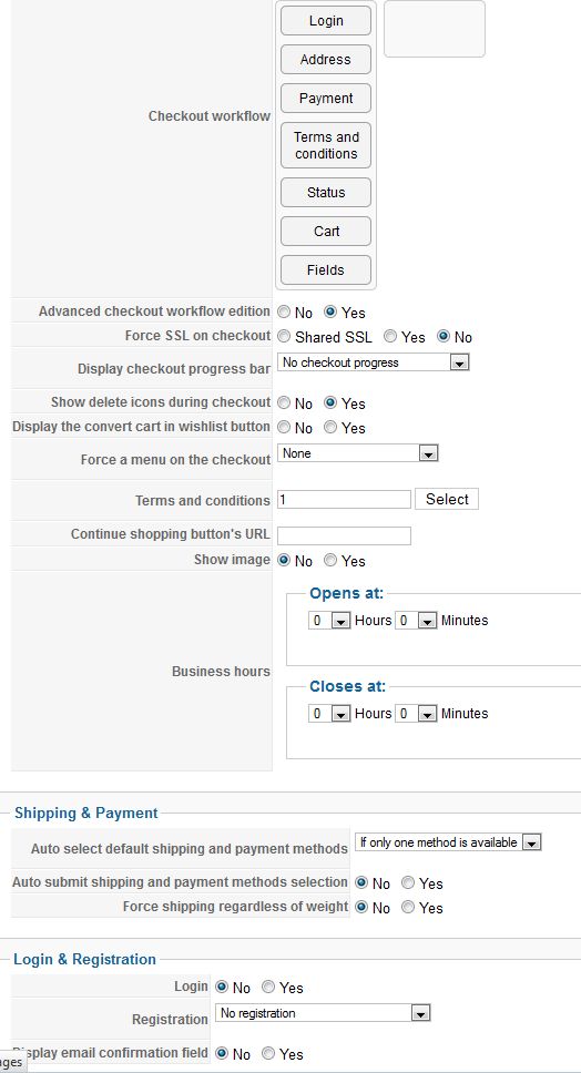

I think I know in which situation the error occurs: My configuration in checkout is workflow "login_address,shipping,payment,confirm_cart_status_fields_terms,end" with no registration, see also the configuration screenprint in the zip-file.
- A customer who has already once done an order will have a record in the database, and cannot register again, see screenprint. No checkout is possible, as he is stopped.
- A new customer can register. In the second screen, shipping, he does get a similar error-message, but this time he is not stopped, and he can proceed to checkout.
I attached screenprints of both situations and of the configuration. Hopefully this clears things up.

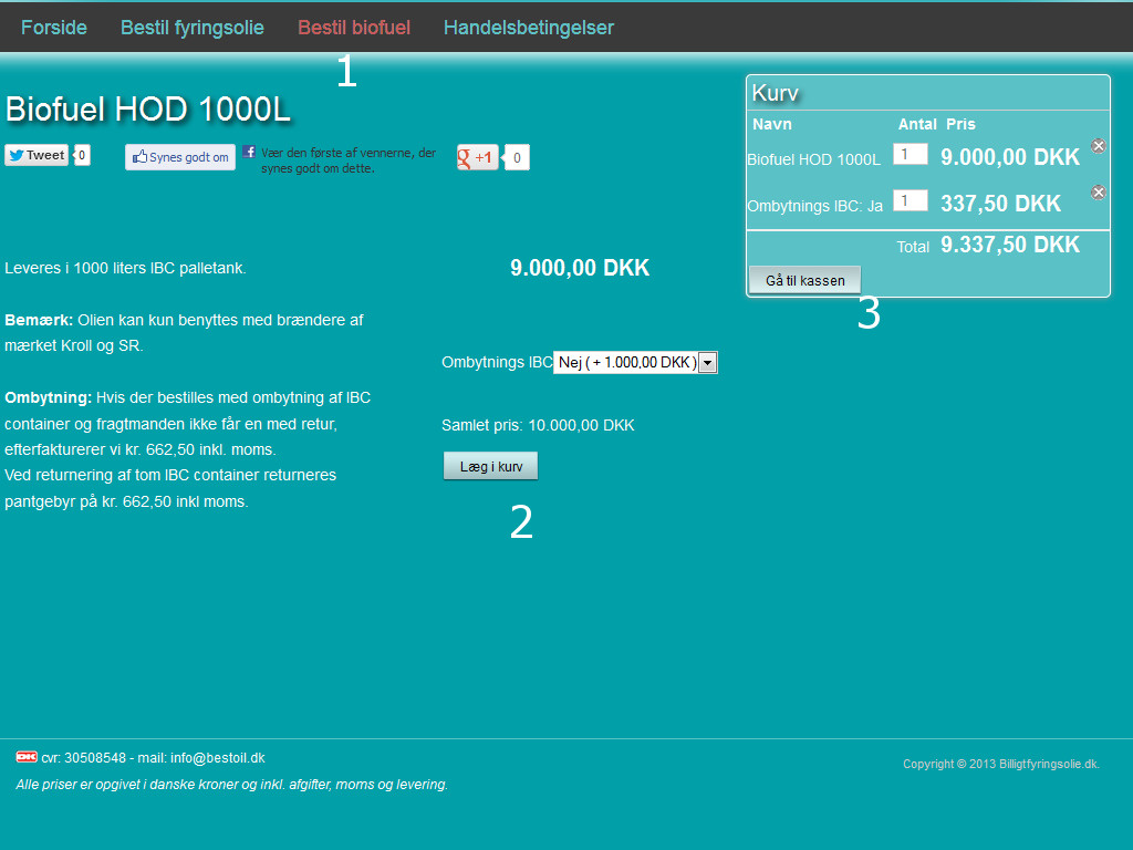

Here you are..
From frontpage I made the same as you
Here is the way round

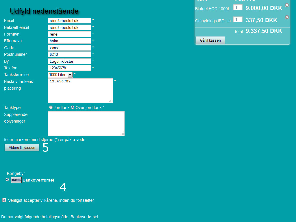

Then i check the terms and the bank, after that I go to the checkout (5)
But when i click here nothing happens.. the fails come ( The image is pressed, thats not the screen)

My checkout in backend
