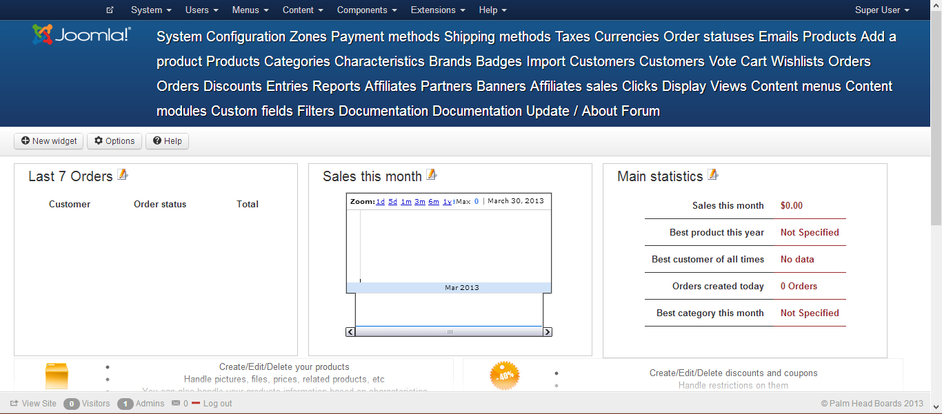

Have just installed Hikashop 2.1.1 on Joomla 3.03. When in the HikaShop admin, it seems the normal horizontal drop down menu is not building properly, and instead is being assigned to the Joomla Admin "page-title" Here's a screen shot:
Is this a known issue? Is there a fix for it?

Change the "menu position" option of the configuration to avoid that.
