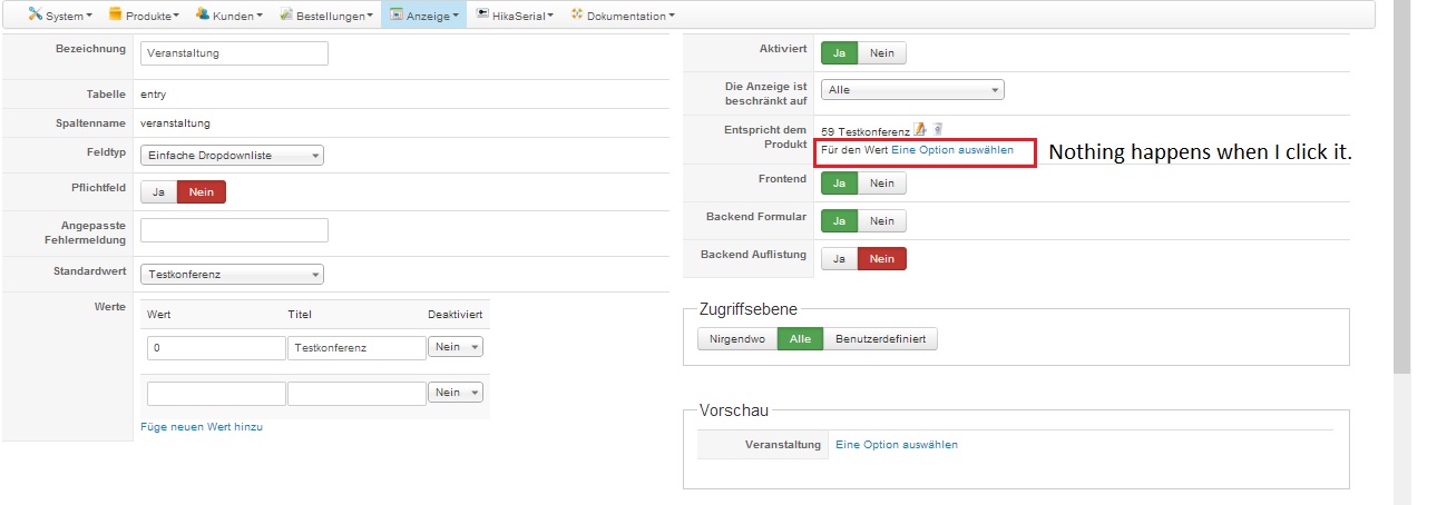

This is for an event registration:
Right now I have a single dropdown with
Value Title
0 Please select
1 Event 1
I want to attach the product "event1" to the value 1 but when I add the product, it sais for the value "select an option" (blue link) and when I click at it, nothing happens. I can´t select a value for the product. How can I fix that one?
I can click save but it changes nothing. There is no option to connect it with a value.

Could you do a screenshot of the page with the problem ?

Here it is.

It is a conflict with the chosen library of Joomla 3.0
Change the line:
<?php echo JText::_( 'FOR_THE_VALUE' ).' '; ?>
to:
<?php echo JText::_( 'FOR_THE_VALUE' ).' '; $this->fieldsClass->suffix='_corresponding'; ?>
in the file "form" of the view "field" for your backend template via the menu Display->Views and that should fix the problem.
