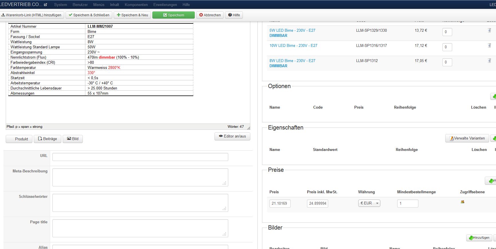

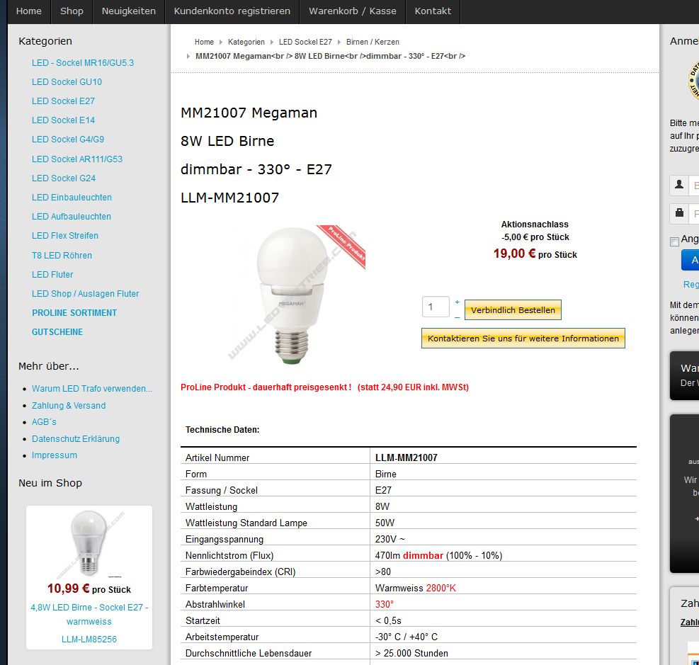

working now with actually update and found following bug !
The Discount don´t work correct !
Productprice - 24,90 €
Discount - 5,00 €
in the Shop in Frontend - Price is 19,00 € (!!!)
what is going on ? :dry:
Is this a bug ? When yes, please help soon as possible, because otherwise i must
delete the discounts and put in the prices manually.
Thanks a lot

  • Posts: 59
13 years 4 months ago #102351
now i test it with another product...
normal Price 49,90 € including tax
Discount should be 10,- €
but on the frontend the Price is 38,10 € ???? :huh:
now i´m complete confused....

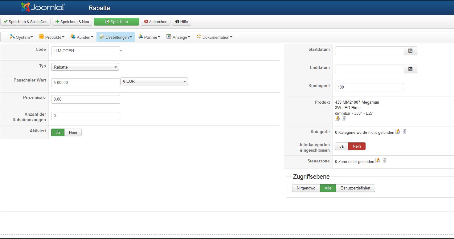

  • Posts: 59
13 years 4 months ago #102353
i have found the mistake.... :whistle:
normaly Discount will be calculate before tax in percent...
so i Switch it in this Position....
But now he is decrease the Discount amount from the Price without tax ...
and so i can´t work... i´m soooo stupid... sorry !
