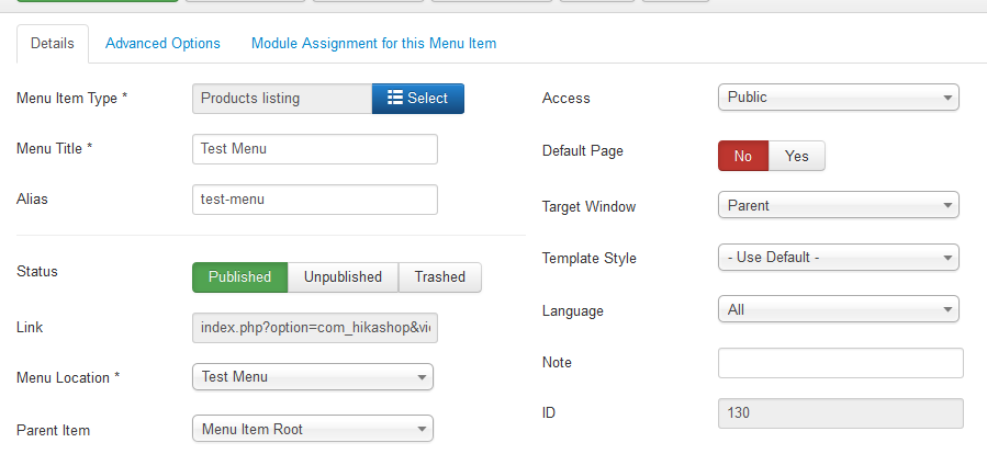

I've run into a really strange problem. I've installed HikaShop twice, and Maximenu twice on a Joomla 3.0 site.
You can see the site at www.bayousome.info
I've added a temp menu at the bottom left which has one menu item "Test menu". The menu item is setup as a Hikashop Product Listing.
Here's the menu item config:
When you click on the menu item, a blank page is returned. Absolutely blank. No HTML code at all.

11 years 1 month ago #104209
You have a 500 error in the page.
Please activate the Joomla debug mode and check your PHP log in order to see the error message.

11 years 1 month ago #104236
It is really strange.
Did you change anything other than the "debug mode" ? Does the error came back if your remove the debug mode ?
Firefox display a blank page but you can see in the network log (ctrl+k) that the page return a 500 error.
In Google Chrome, a special page is displayed when there is a 500 error.
  • Posts: 43
11 years 1 month ago #104276
There was a problem in one of the php files, a small syntax error. Once that was fixed, the page displayed correctly.
