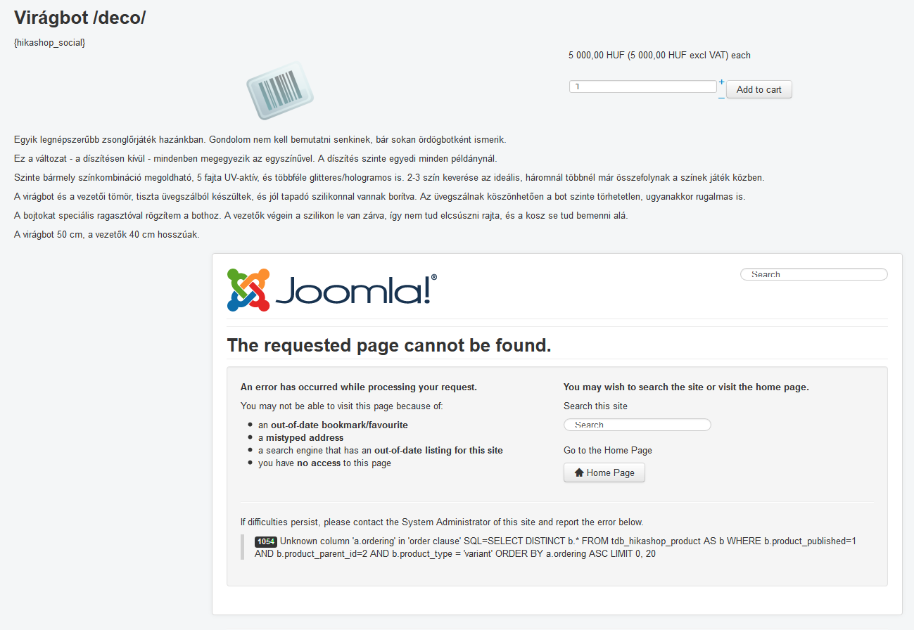

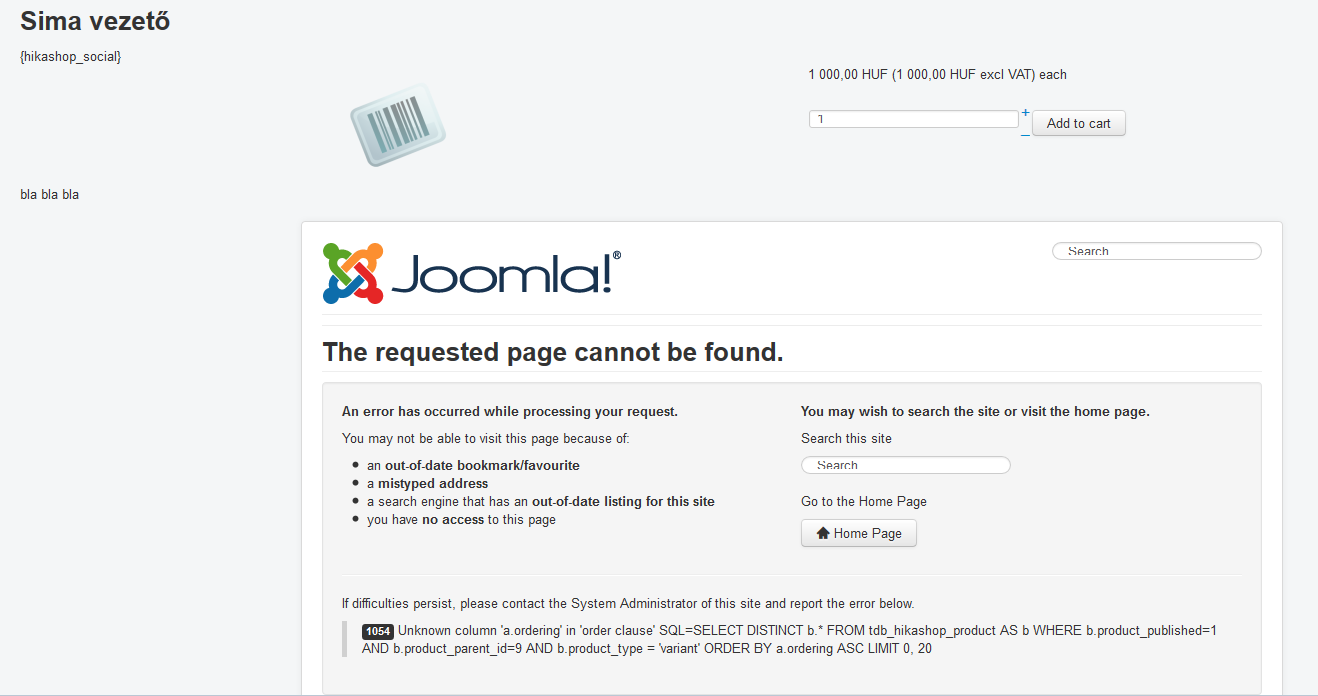

I newly installed a pure Joomla 3.1.1 system, added some content and two languages. Also installed HikaShop 2.1.3, and added some categories and a dozen products to it. Everything is fine, until i'm trying to view a product. Then this error message welcomes me:
1054 Unknown column 'a.ordering' in 'order clause' SQL=SELECT DISTINCT b.* FROM tdb_hikashop_product AS b WHERE b.product_published=1 AND b.product_parent_id=9 AND b.product_type = 'variant' ORDER BY a.ordering ASC LIMIT 0, 20
I checked if corresponding databases are exists, and it seems allright. Therefore i cannot find correct answers on any forum, i was thinking, maybe you could help. I attach a picture about the screen how now looks like with this error-message on it.

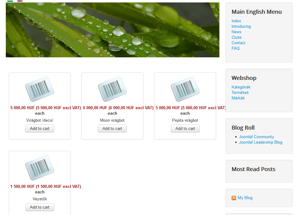

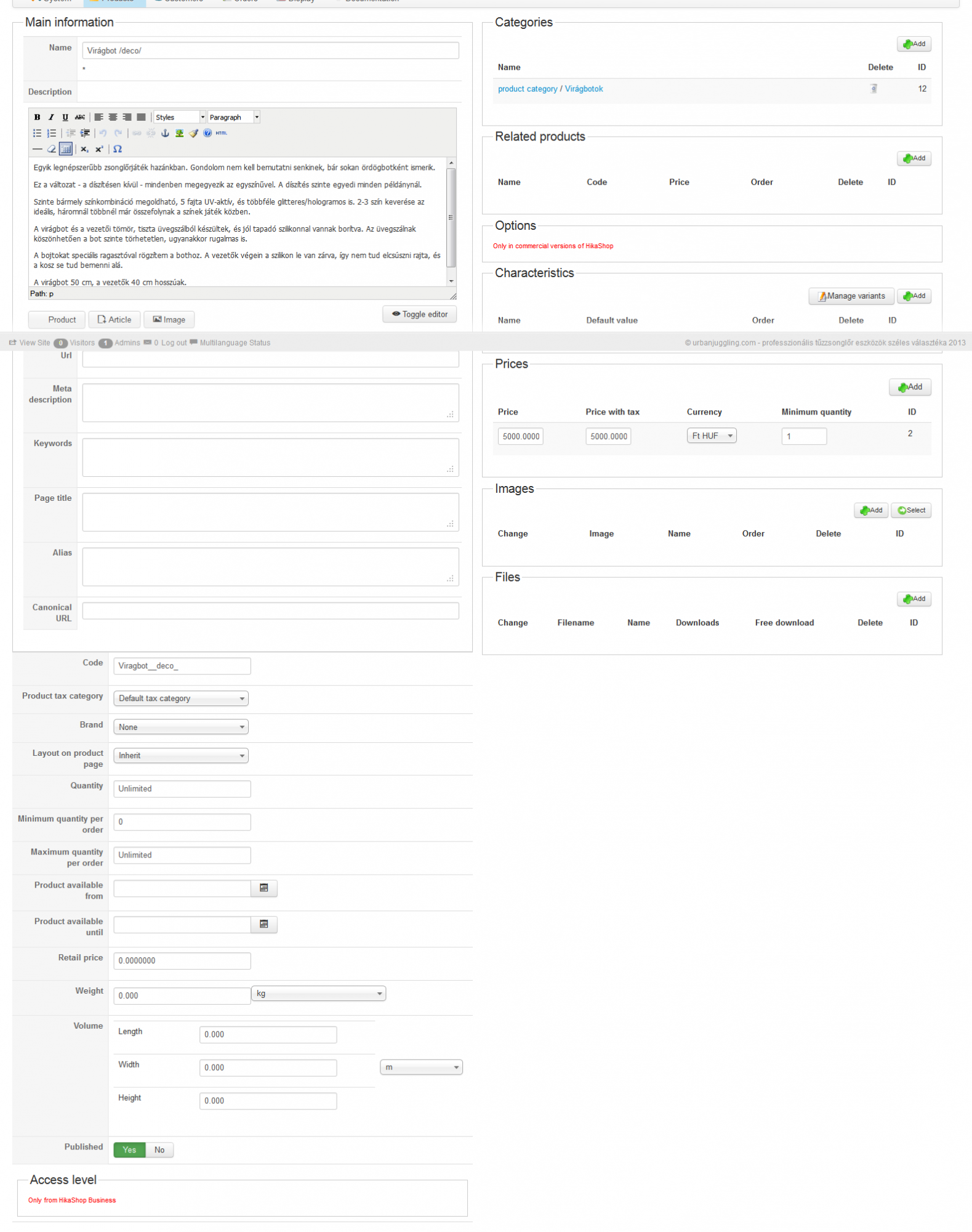

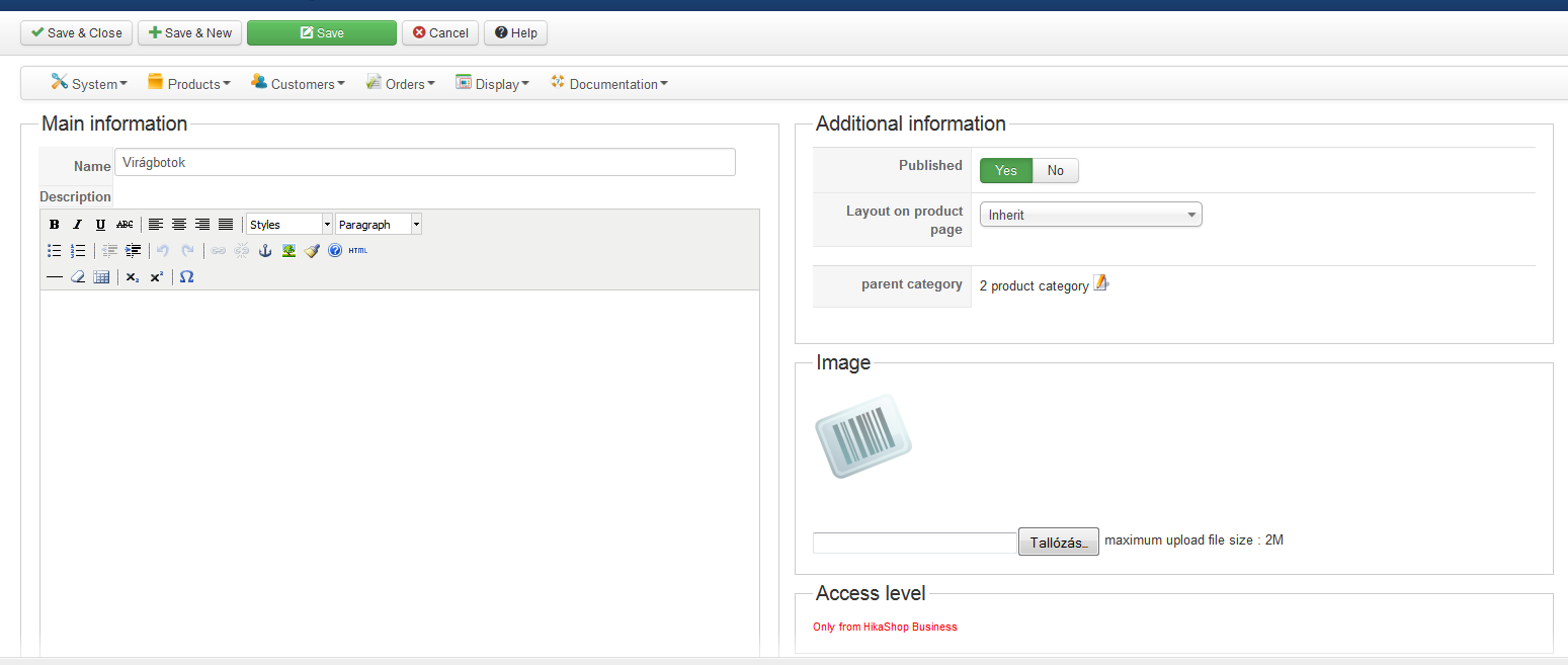

I do not clearly undrstang, what you are saying ,but here are screenshots from my category and product pages (both front-end and back-end sides), maybe it could say mor than i :)

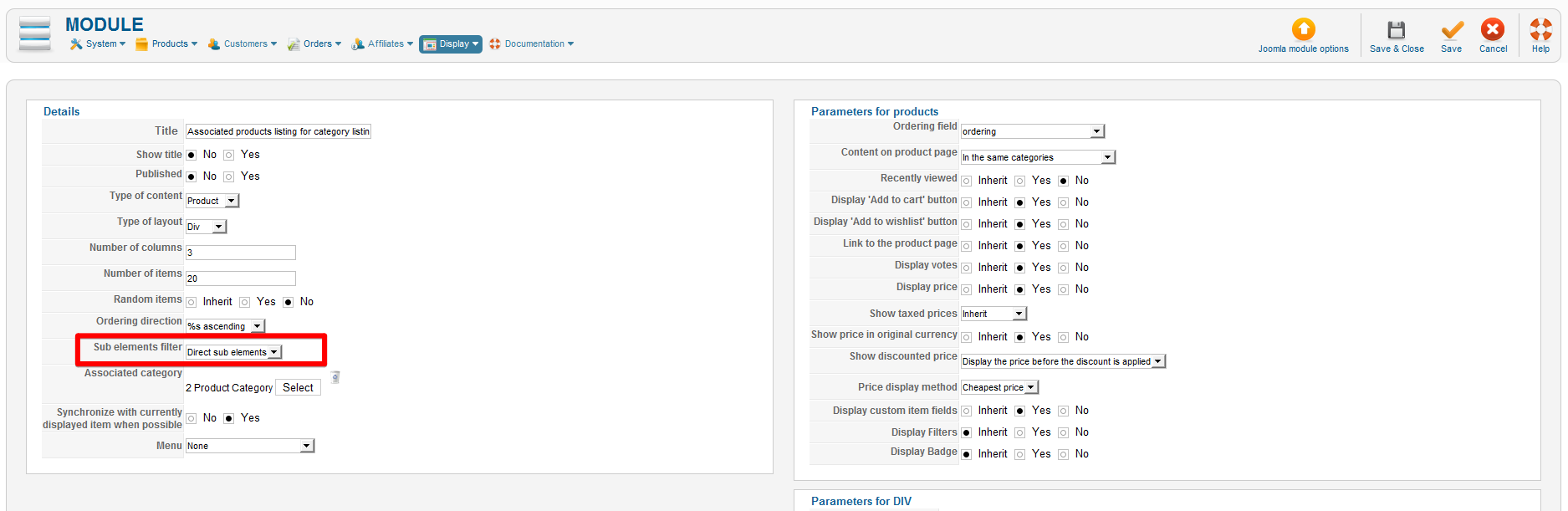

Disabled and uninstalled HikaShop, installed the 2.2 version and now it works ^^ One more question.. how can i set up the main view to show onlz categories, and products will be visible only in the categories sub-pages?
Sincerely,
Z.
  • Posts: 86181
13 years 2 months ago #112180
In the HikaShop options of your menu, click on the link to the associated products listing module and there change the "sub element filter" option and that should do it.

  • Posts: 2334
  • Thank you received: 403
13 years 2 months ago #112244
Here is the option :)

  • Posts: 8
13 years 2 months ago #112412
Hello.
Works like a charm ^^ Thank u all your patience and 'helpdesking' :)
